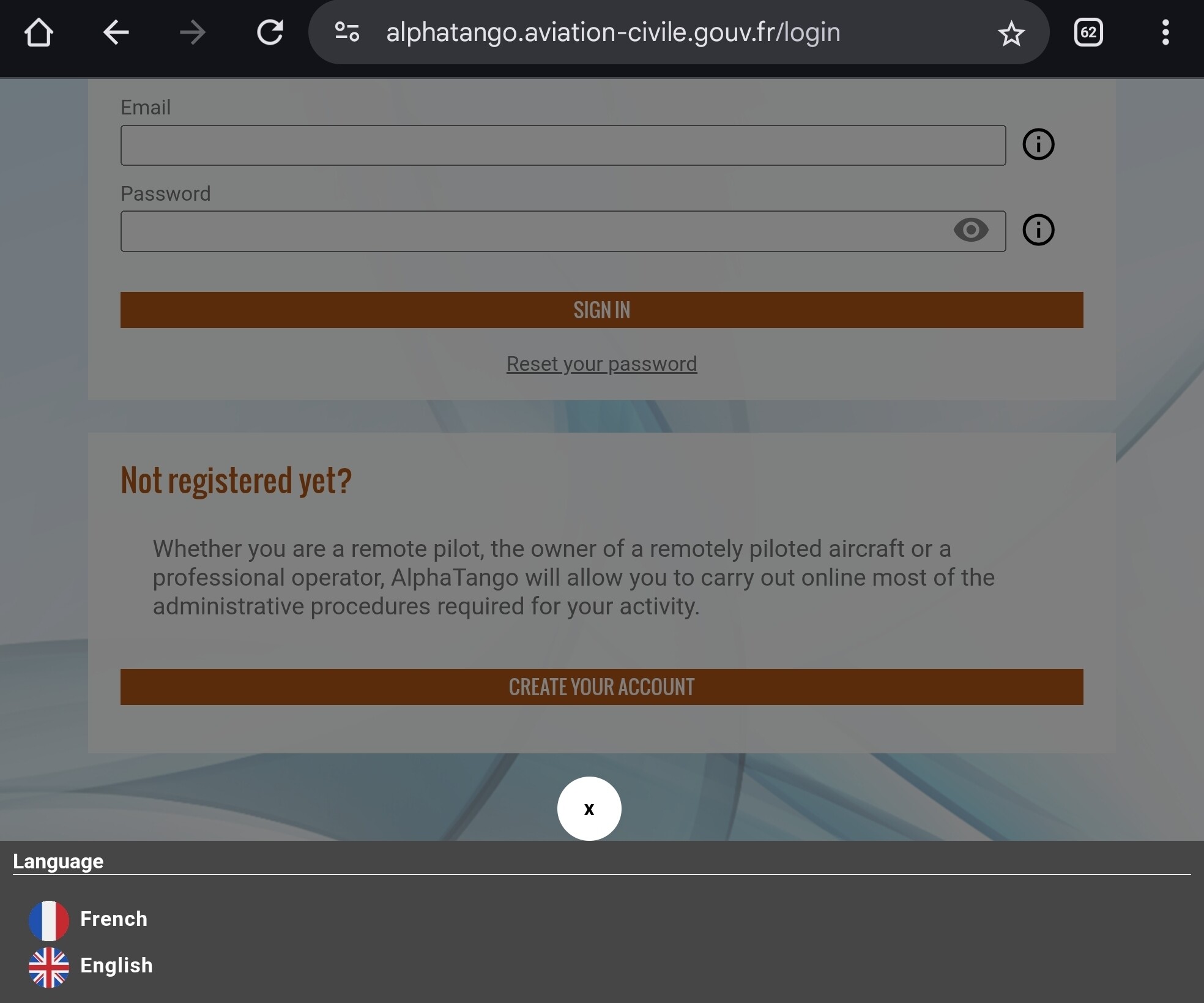

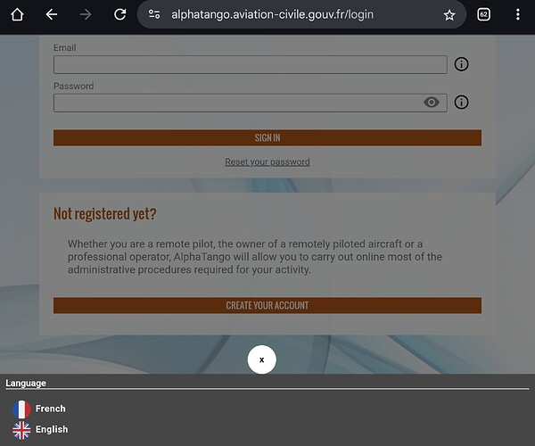

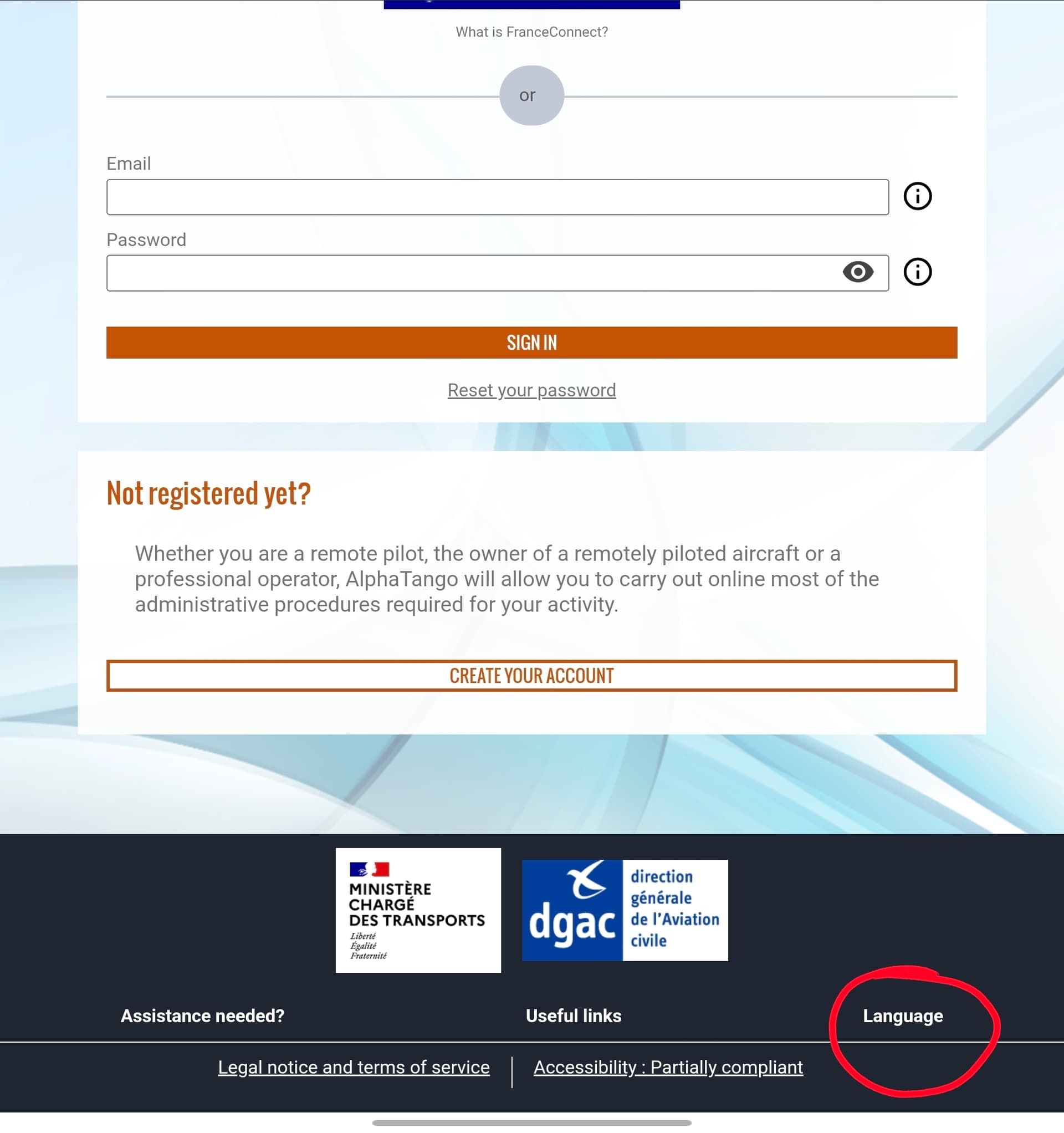

  1. On that first page, change the language to English (‘Anglais’) at the bottom. (This is important because, if your browser translates it to English instead, it causes issues because you won’t find the UK in the drop-down list of countries).

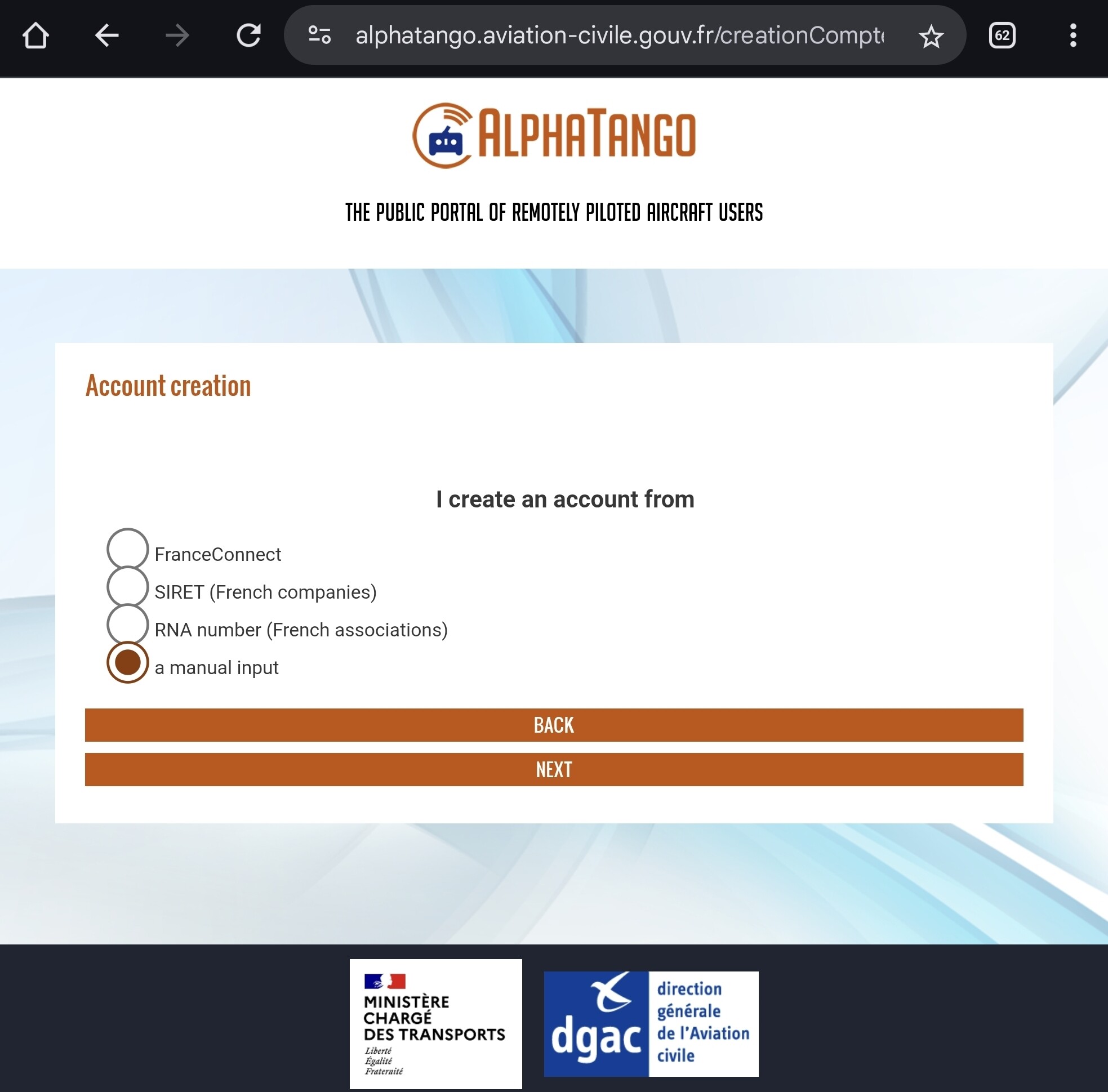

  1. Choose ‘Create your account’, then ‘A manual input’.

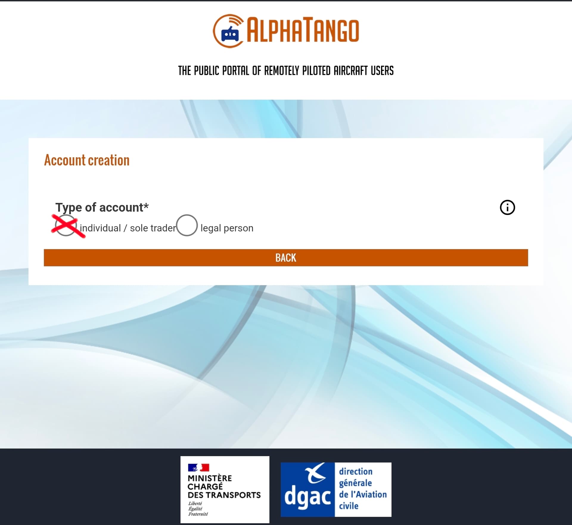

  1. Choose ‘Individual / sole trader’.

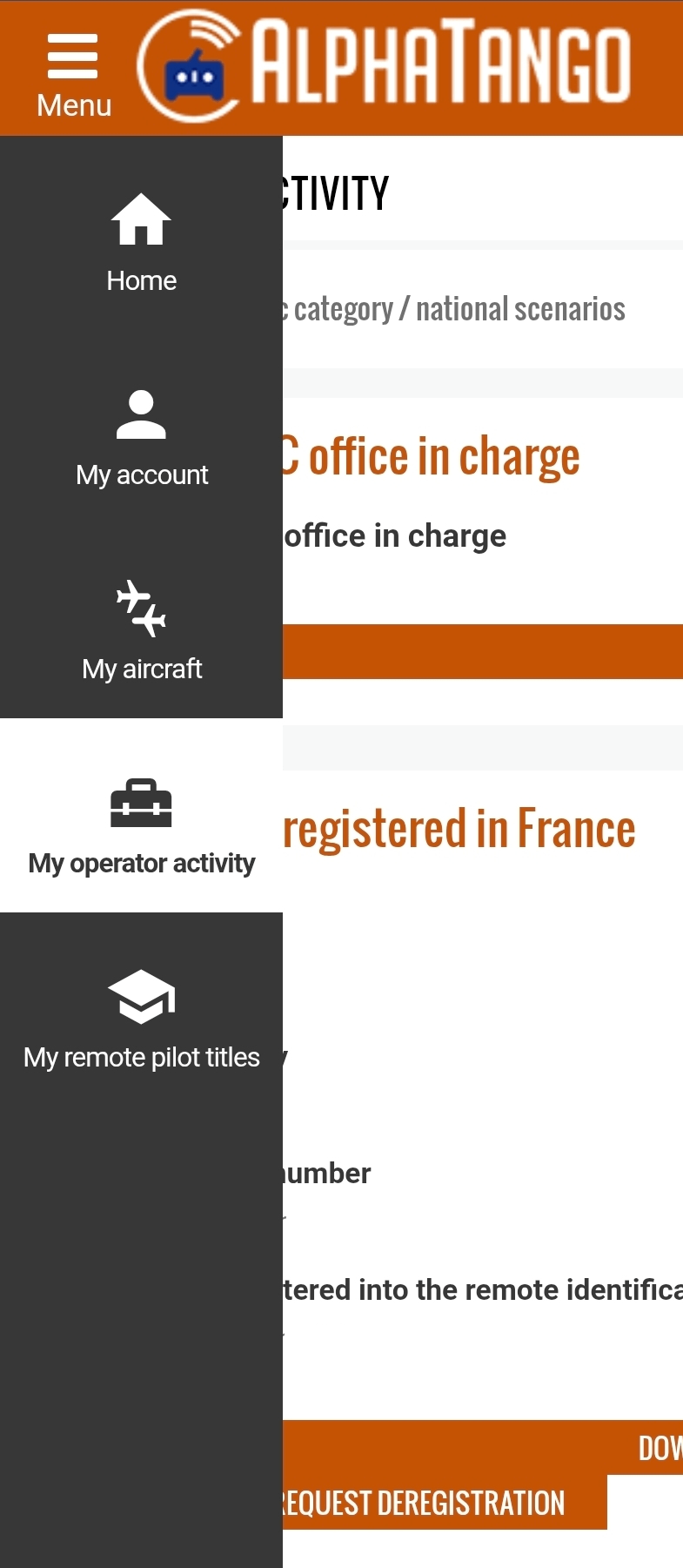

  5. Press ‘Menu’ and ‘My operator activity’.
  6. Under the heading ‘UAS operator registered in France’ press ‘Register’.

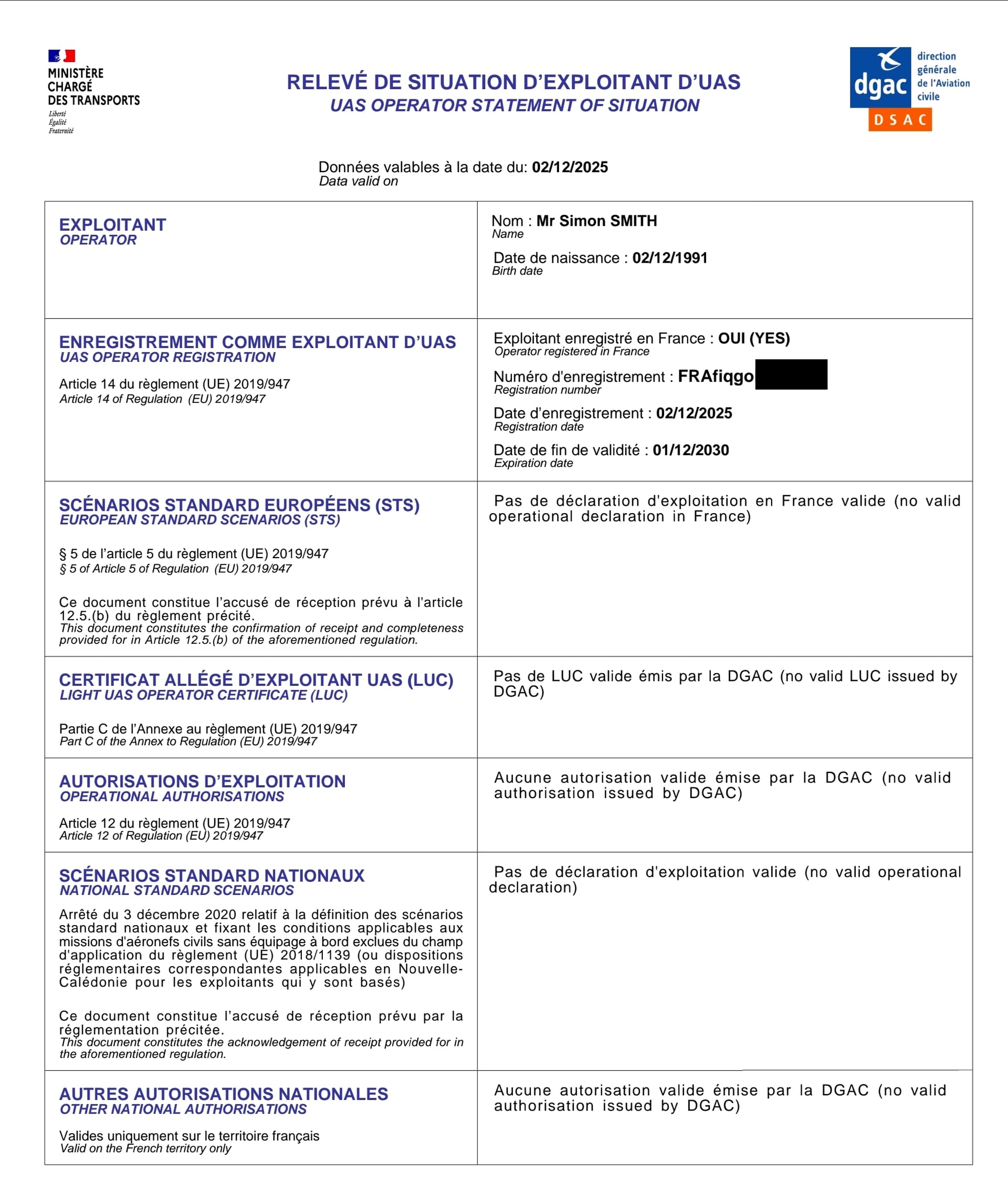

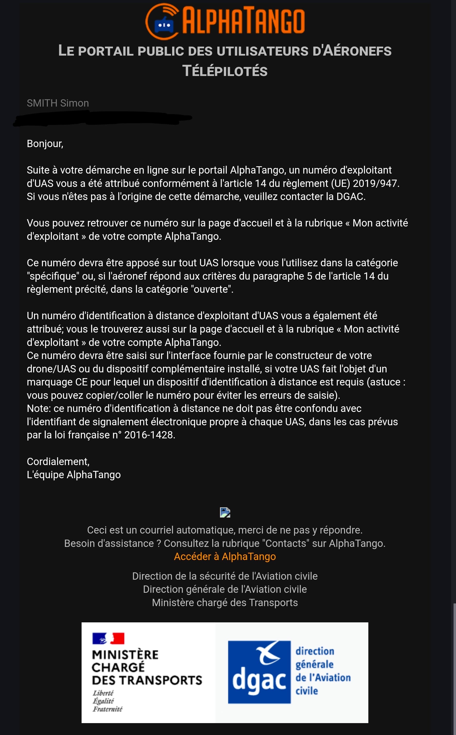

You will then see a green message saying that you have been assigned an EU Operator ID and you will be asked to sign up for the newsletter. Press Cancel on the newsletter box.

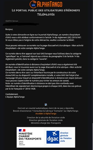

You will receive an email, in French, which says that you have been assigned an operator ID and it is visible under ‘My Operator Activity’ in your account.
  1. Log back in to your account and press ‘Menu’ and then ‘My operator activity’. You can then see your EU operator ID.
  1. Press ‘Download a statement of situation’ to download a PDF showing your operator ID and registration details.

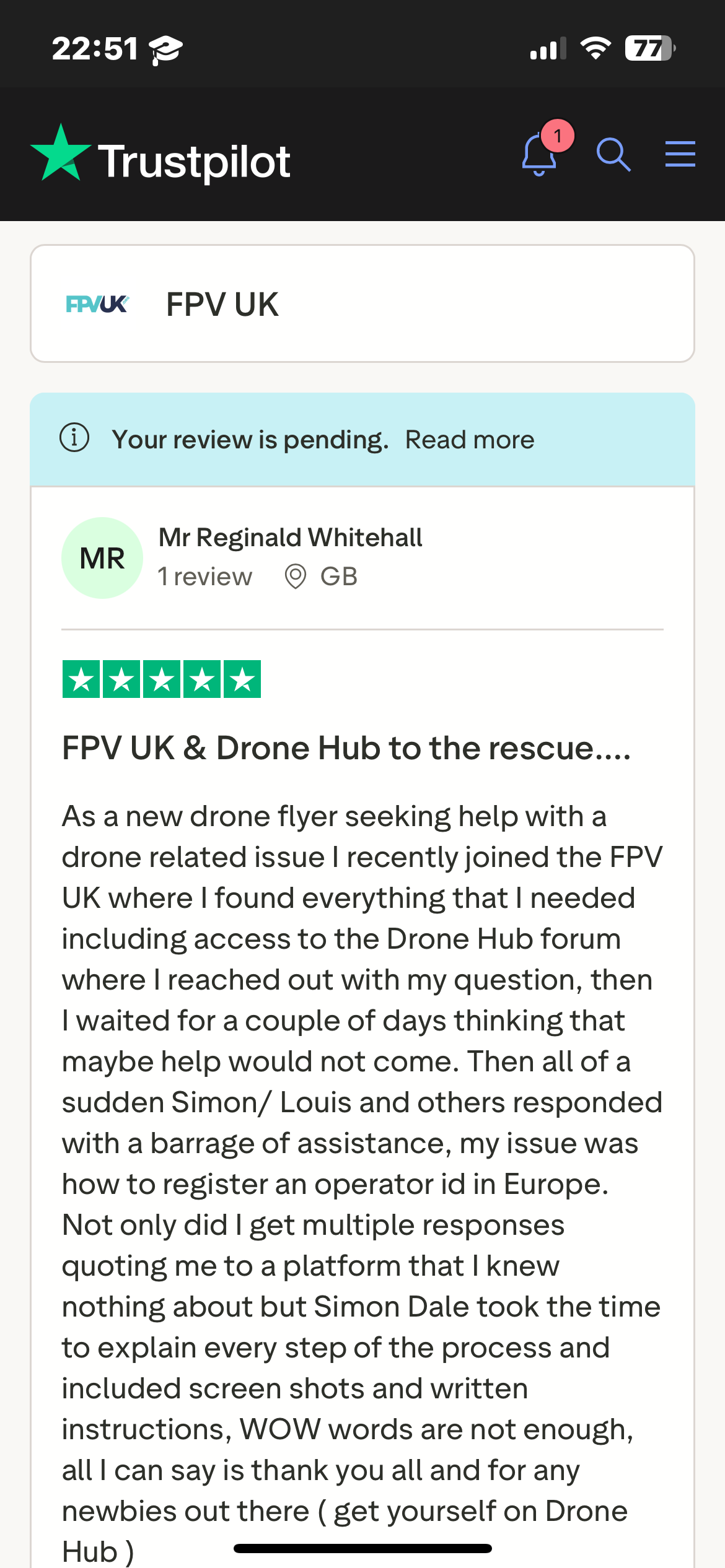

I wouldn’t say no to a Trust Pilot review, if you’re willing? Rate FPV UK
That’s brilliant - thank you so much!
I really appreciate you taking the time to do that for us.
