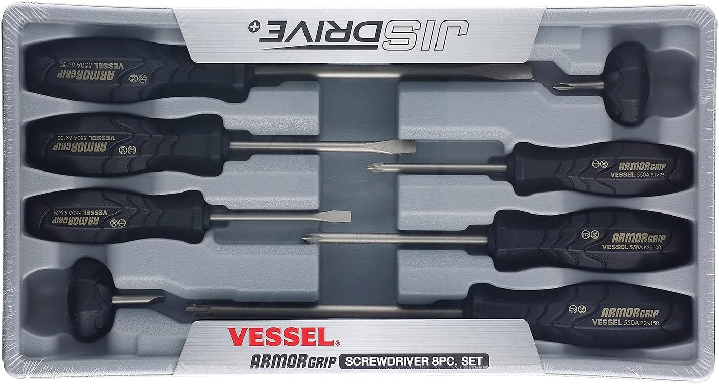

Most people don’r realise that the coss head screws on precision products made in China, Japan, Korea etc aren’t Phillips. If you use PH scewdrivers your running the risk of graunching the screw heads.
The cross head screws used on products from this part of the world are JIS heads (Japan Industry Standard). They look similar to Phillips but the angles and dimensions are slightly different.
Only use JIS crosshead screwdrivers on your DJI Drones.
Here’s great set of miniature screwdrivers for drones, cameras etc. that I use:

However not too expensive to replace from Amazon. Vessel tools are first class !
Even true of bigger stuff, if you own a car or motorbike from Japan, Korea or China.
Throw away your phillips screwdrivers unless you want to chew up screw heads and get a proper set of JIS screwdrivers,
This is the set i have:
