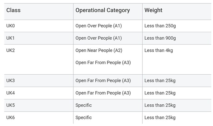

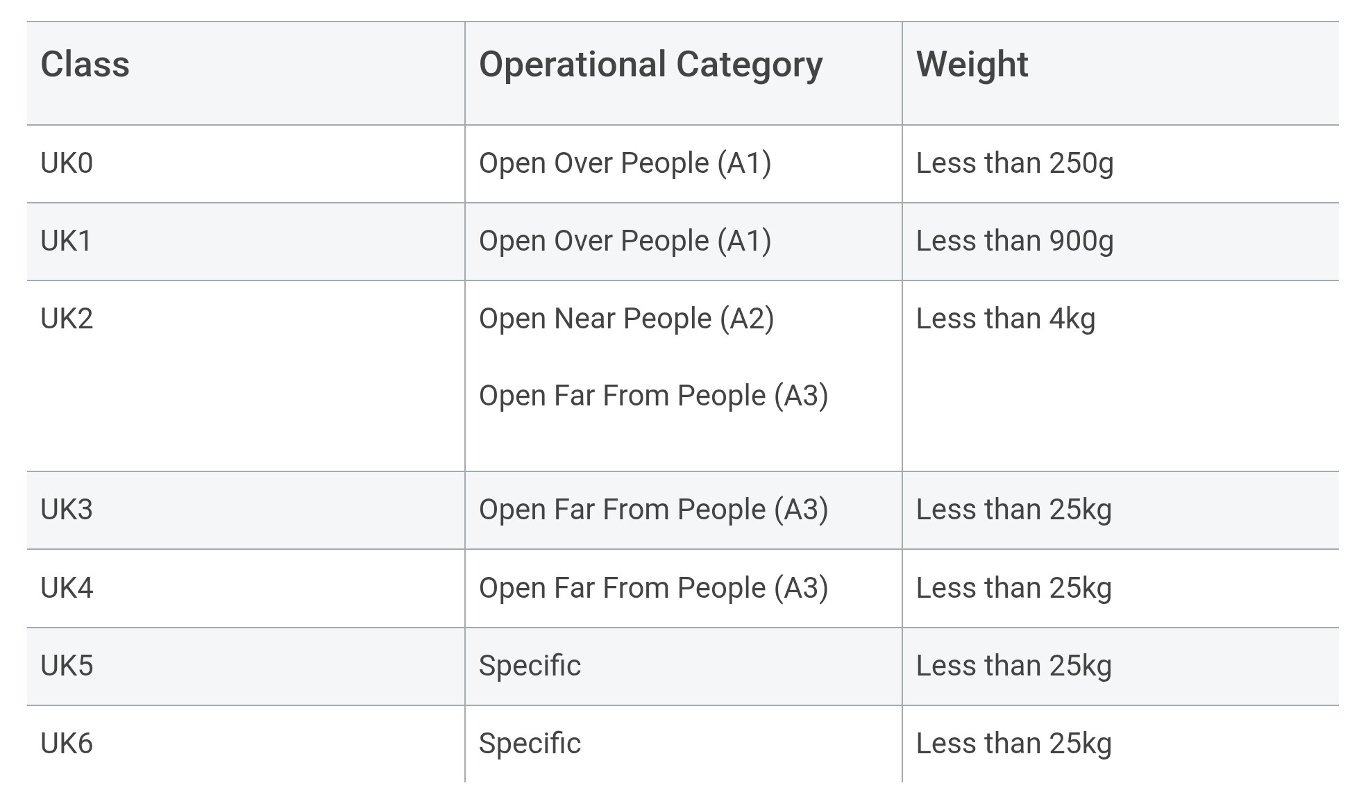

Partly true.
You will be able to fly an uncertified 900g drone in A3 - far from people and buildings. Same as an uncertified 249g drone.
A certified 900g drone can fly in A2 - closer to people and buildings. And moving vehicles.
And a certified 249g drone can soar in the freedom of C0.

There is no ‘new sub-100g category’. You are confusing the weight where you need to do a Flyer ID. That’s a different thing.
Class marking (C0 in EASA and UK0 in the UK) is not certification. Let’s not confuse those terms. Certification is something different that applies to manned aircraft and unmanned aircraft in the Specific Category.
Class marking has only recently been announced. I don’t think manufacturers have ignored it.
No, a sub-250g drone is not necessarily a C0 drone. It is, and will remain, a sub-250g drone. (This is a legacy drone if you will, it is not class marked, but it is sub-250g, nothing changes for these).
Secondly, these sub-250g drones (which may, or may not have a C0 or UK0 class mark) don’t suddenly have to be flown in A3! That would mean every DJI Mini in the country would go from being flown basically anywhere, to only 150m from built-up areas. That is not the case at all.
Sub-250g drones will continue to be flown in A1. (Class marked, or not).
C0 and C1 drones can be flown in A1 until 2028. (But if they are sub-250g they can be flown in A1 on that basis).
UK0 drones will be flown in A1.
It seems that you’re imagining rules and regulations, and limitations and requirements that don’t exist. I am very pleased to be the bringing so much good news!

That is wrong.
A sub-250g drone (‘legacy drone’) will also continue to be permissible in A1.
  1. Certified is wrong. You mean class marked.
  2. C0 is wrong. You mean A1 I think?
  3. The concept that a sub-250g drone has to be class marked to be allowed to be flown A1 is wrong. Non-class-marked sub-250g drones will continue to be permissible in A1.
Actually, a class marked UK1 900g drone will be permissible in A1.
