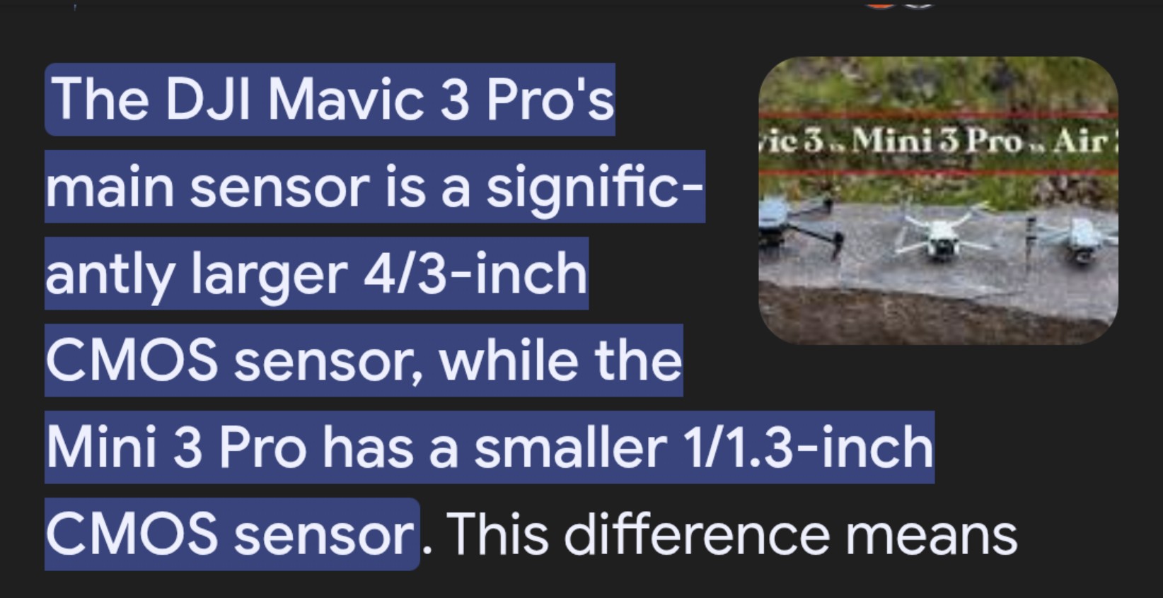

I know it has a superior camera to the Mini 3 Pro, but it is still a 4/3 sensor, which might be the bees knees in drone cameras but compared to stills cameras that’s just a standard prosumer sensor size.
So I think it’s a fair question.
The thermal only does jpeg but the 3m and the 3E both do raw. The mini 3 pro doesn’t have 4/3 sensor and that is why I was surprised by the comparison but yes you are right it is a drone camera but it is very good one. I can see the difference even between the Mavic 3T main camera and the Mavic 3M main camera. Especially for night shots. They both can do night shots but the Mavic 3T is all iso so it doesn’t look anywhere near as good. Get back on subject yes I’ve have been happy with the DaVinci resolve grabs then process in lightroom but I’ve only really done this for fireworks so far. Mainly because I was struggling with the timing to get the best shot of the firework. So for a completely different reason. Another advantage of the Mavic 3M it can take photos every 0.7 seconds when in jpeg mode only. All the other drones I have only take photos every 2 second when in jpeg mode. So timed photo and hyperlapses are usable to break up with the Mavic 3M because it’s fast at taking photos compare to other drones. None of this is really helpful for FPV. What I’m trying to say this will cost money even if we do a self build because of the camera specifications. I did not want two Mavic 3 but I did want a 20 megapixel camera for mapping and roof inspections and a thermal camera for pet searching. This is how I ended up with two of them. I had enough at the time to get the 30t as well but I couldn’t afford two of them as these have the same problem. I would have to get two so I when for the quieter option and I could afford all the accessories with this option. I hate doing the same thing every day so I diversified instead of specializing. This was going against all the advice I had all the time. Literally from everyone. Sorry I’m going on. Do you think there is a cheap why to do this?
