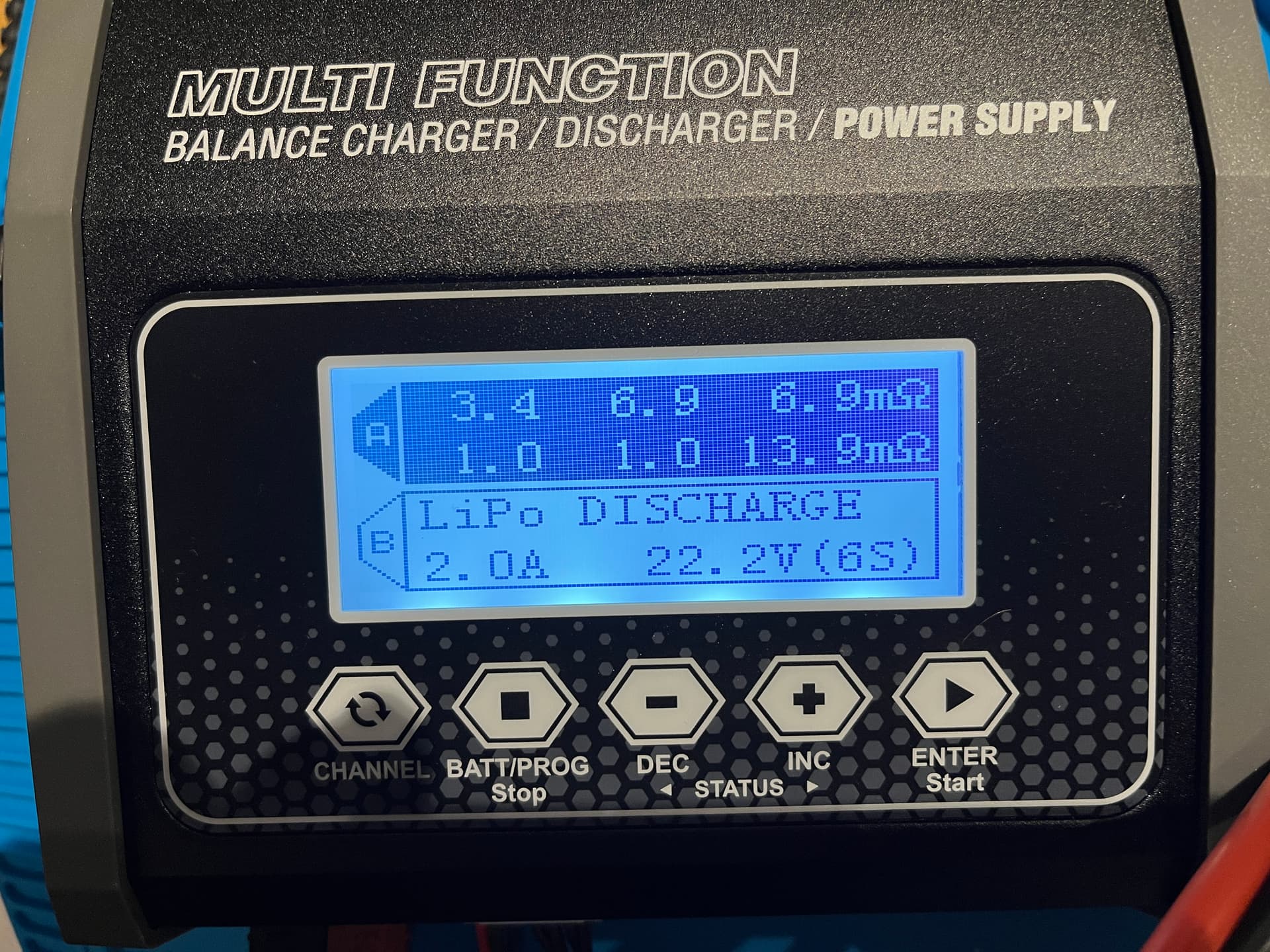

First off, the battery - a sage on it’s own! It arrived eventually! However, 4 of the 6 cells gave readings of zero! Not impressed, to say the lease. That was a few days ago, I have one of these -
SKYRC Ultimate Duo D260 Smart Charger AC/DC 260W - Kings Lynn Model Shop
Connected up did a battery check and only 2 cells showed a voltage. Complained to the supplier, still waiting for a reply. I have an adjustable desk PSU, so I connected it up before turning it on, I set the voltage to 22.2 = 6S. Wound the Amperage all the way down. Turned it on and with a cell monitor on the balance wires, monitored each cell. Gradually increasing the amps… after a while of monitoring, the cells and battery temperature, all cells showed 2+ volts.
Disconnected and reconnected it with the balance wire and main power lead to the SkyRC set to charge at 6amps with 3hours limit and 12,000 mAh total. after 36 hours of monitoring it, it finally reached 100%!!!

Do Not Use The Battery
The cells have been fully discharged and will be damaged. You may have got some voltage into them but under heavy discharge they will heat up and swell. Return the pack to the manufacturer and get a refund. Be very careful charging them, use a battery box that is rated for such a large lump of lithium.

Battery - I wondered if it had not been charged at all, what with shipping. Having said that I don’t know how the manufacturing process works, specifically at what point they add power/charge the cells.
My balance charger has charged it to full, with no hint of any heating at any point. I now have it in 2 x LiPo safe bags on a dis-charge cycle at 2 amps. I’m monitoring the discharge rate and any change in temperature. While 2 amps is not really stressing a 70c capable battery, it will reduce the risk when returning it. Thanks for the warning!

I think this is sound advice. You can’t be too careful, and they should give you a refund.
However, isn’t the 0.00V reading a product of the BMS circuit? Isn’t it possible that the actual voltage of the cells in question was actually 1.98V but the BMS cut them off to protect them?
I’ve had some success with a 6 x 18650 pack by connecting directly to the cells and getting them back above the 2V threshold, then the BMS would allow a connection to them, and the charger would charge them again.
As above, better to be safe than sorry. You could even do a credit card dispute if it came to it.
These batteries generally don’t have a BMS. They have difficulty dealing with the current and being lightweight at the same time.
The chemistry is such that these cells will have been degraded and will have a high resistance at high current. On a 13 inch quad currents will be up to 200A. These cells are just waiting to catch fire now. Ditch the pack and save the quad.

Thanks @SimonDale as mentioned, I’m currently running a discharge cycle on the battery, to make it ready for return.
I do find it strange that 4 of the 6 cells arrived here with no charge. Was it the MBS as you mentioned @SimonDale or is this a faulty batch?
I suspect the BMS had something to do with it, as after giving it a ‘Kick’ as it were with a conventional charge method, the smart balance charger charged without any hint of the battery heating up.
However, better safe thansorry, it’s going back and I’ll get a full refund! one way or another!

Just as a final note about the battery, yep, the resistances are… well ALL over the place!
