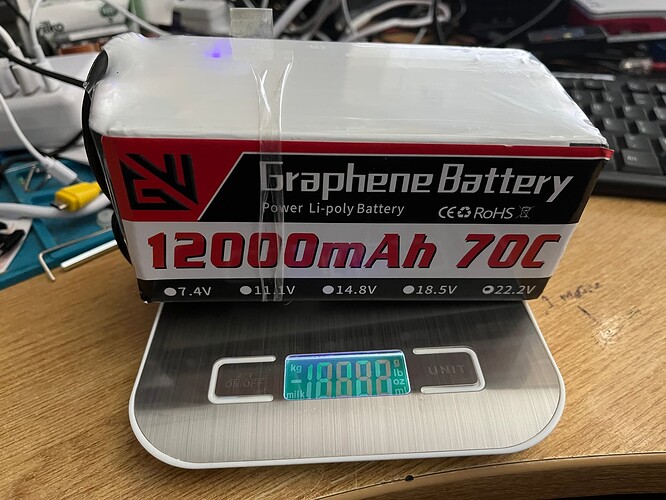

Just arrived! A real beast!

That is a beast!
8S 12,000mAh 70C?
How much does it weigh? I can’t make out the numbers on your scales.
nope, it’s 6S and comes in at 1640g. Just have to work out how to setup the new charger/balancer but no real hurry…
Edit: In a word, it weighs too much, and the shape is not good, wanted longer and slimmer…
Currently in two LiPo safes on my desk!

Yep, It’s going to have to hang underneath, I think it will balance better there. What do you think @SimonDale ?
I am going to check the weight on another set of scales just to be sure, it was listed as 1545 I think it was, probably with a +/- bit not sure…

Underslung sounds legit to me. (Although I am no expert in such things).
