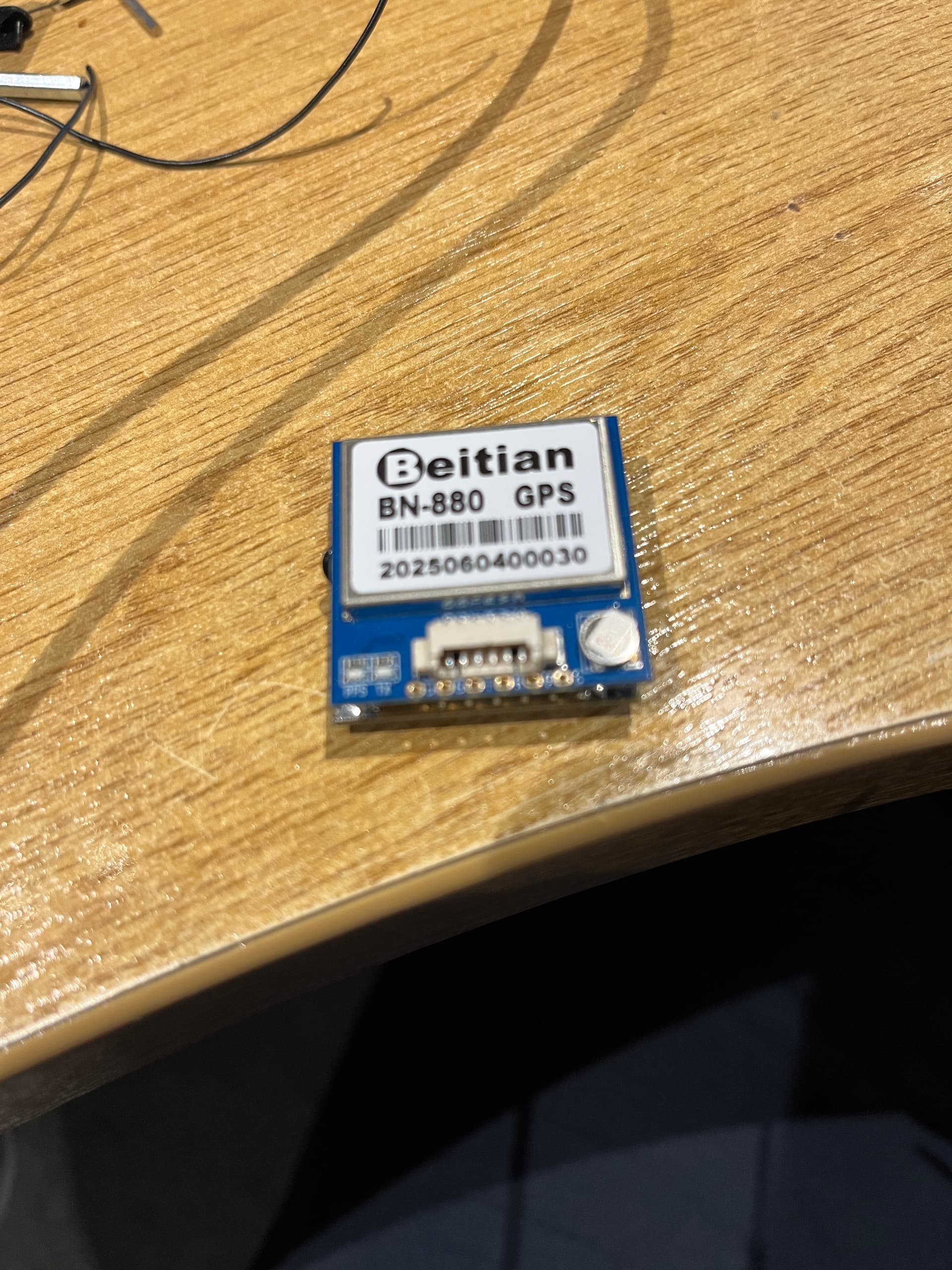

Connector? For an antenna?
No, comms

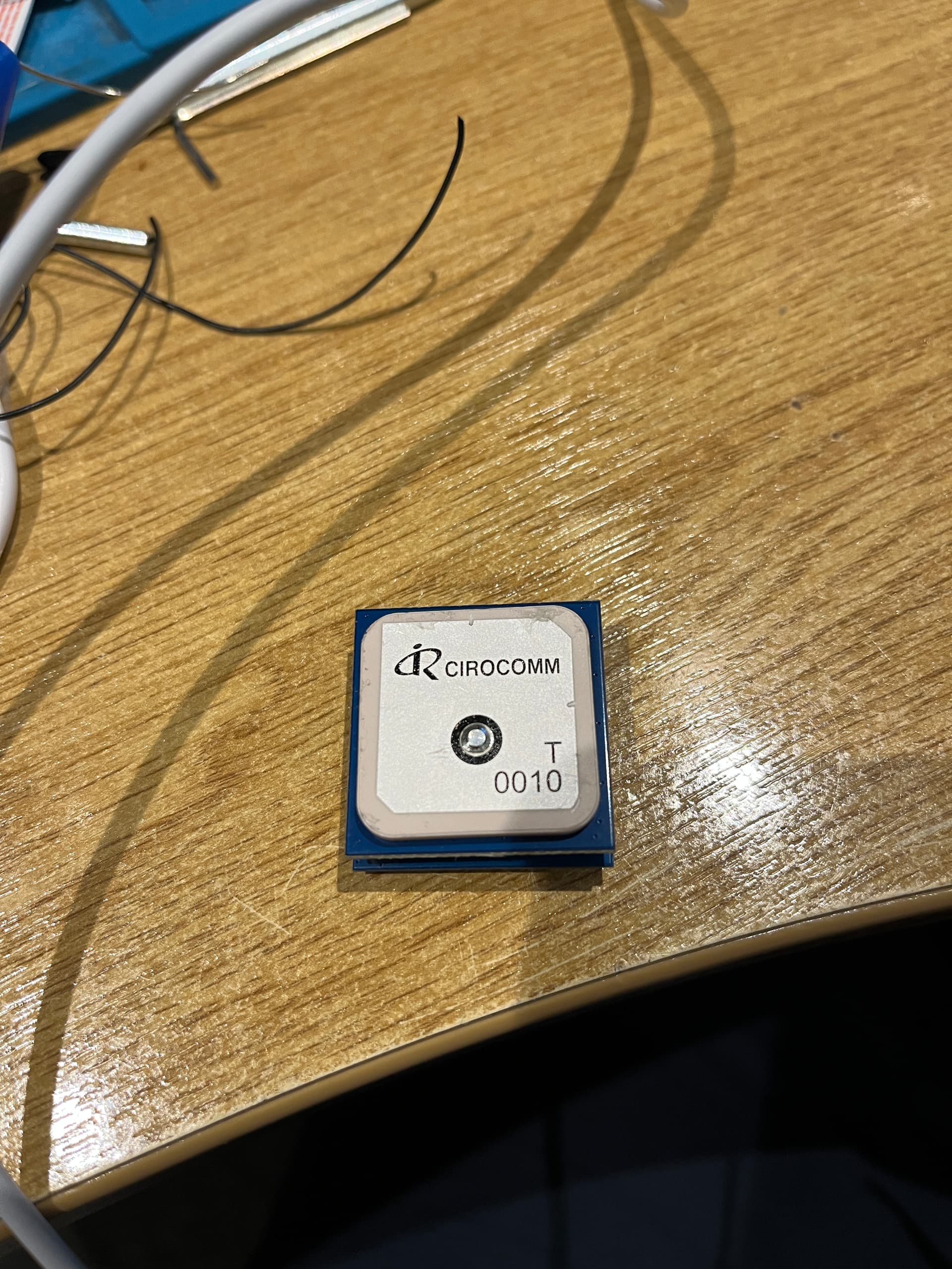

So which face is the top?
Cirocomm side up.
Thanks @SimonDale
Is it going to be ok located on the front of the craft above the camera?
With the battery doing to take up most of the top the very front is about the only place it could go.

Your GPS location should be ok. It would be better at the rear, especially for the compass, but it should work.
What fight controller are you using? I’ve not seen data flash at 0 before. But if it programs simply enabling the GPS should not cause it not to work. It’s more of a RAM or loop time issue. With a large quad with many sensors, an F4 co u might be getting full. The data flash might also relate to the black box. I’ll pull out BF later on and have a look.
