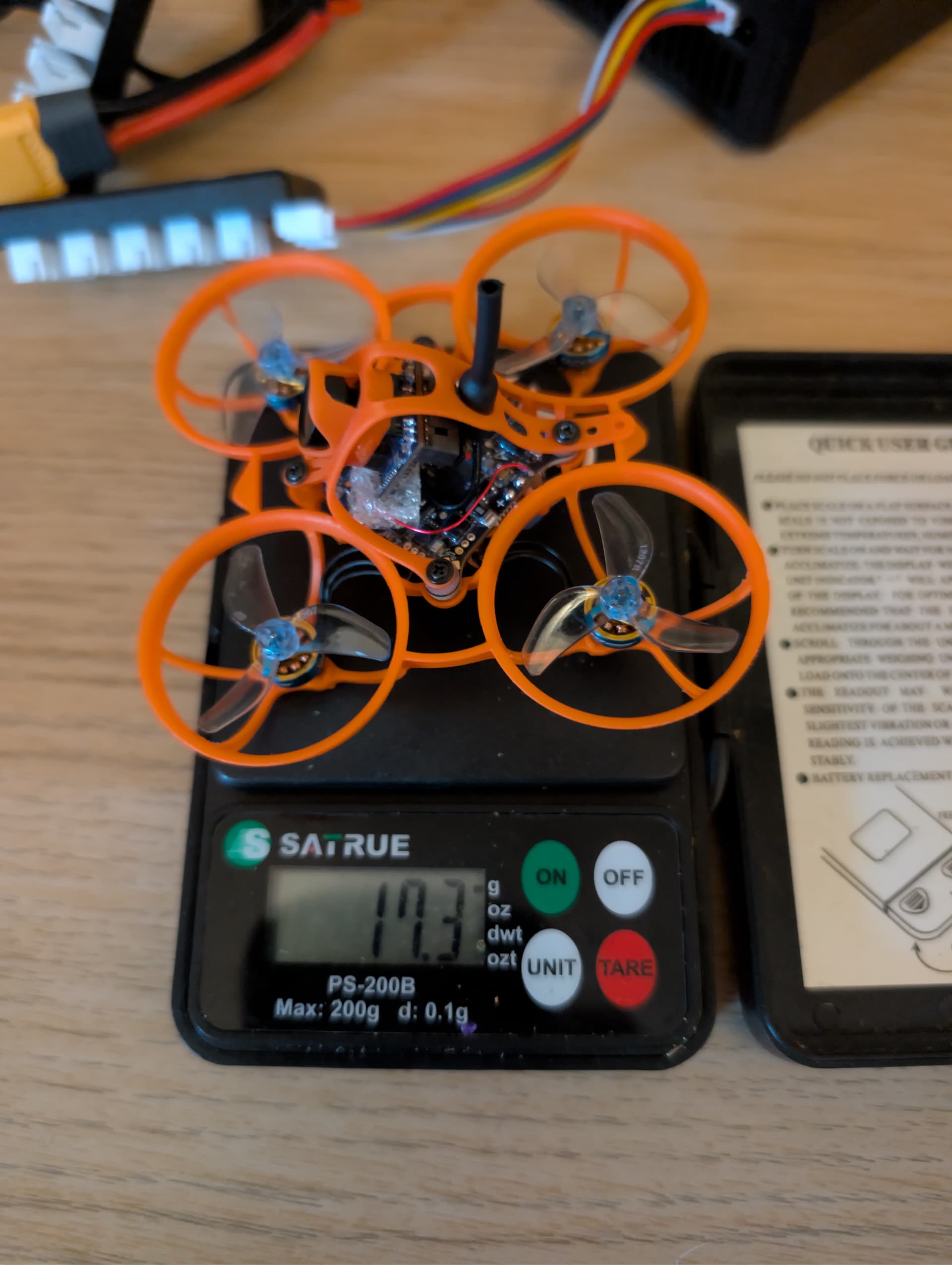

Built a couple of Tiny Whoop for flying round the back gardens. Trying to dig myself out of this funk, hopefully being able to fly without a load of prep and a drive out for the day will help…

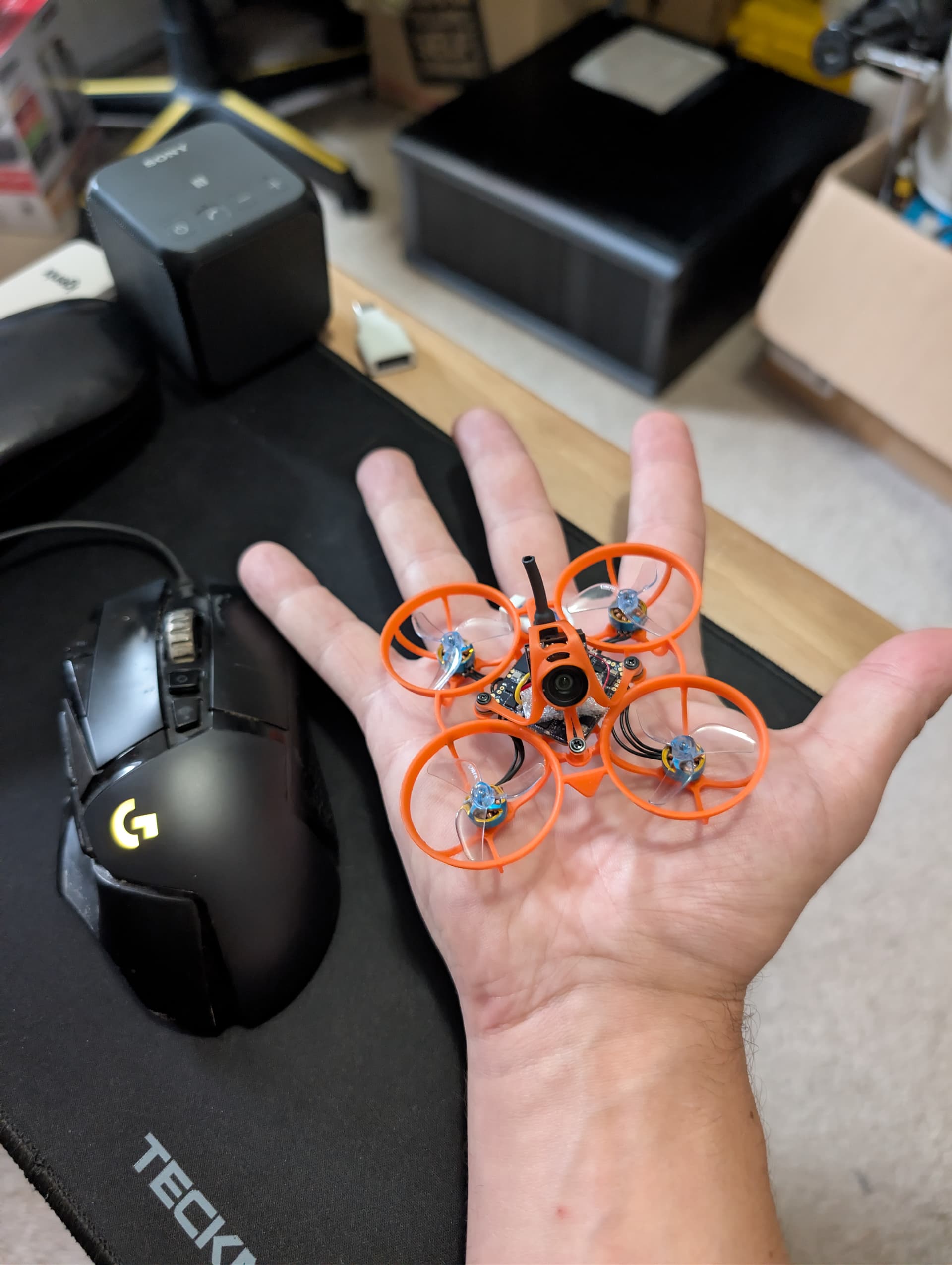

Anyway, some pics, G502 mouse and hand for scale… ![]()

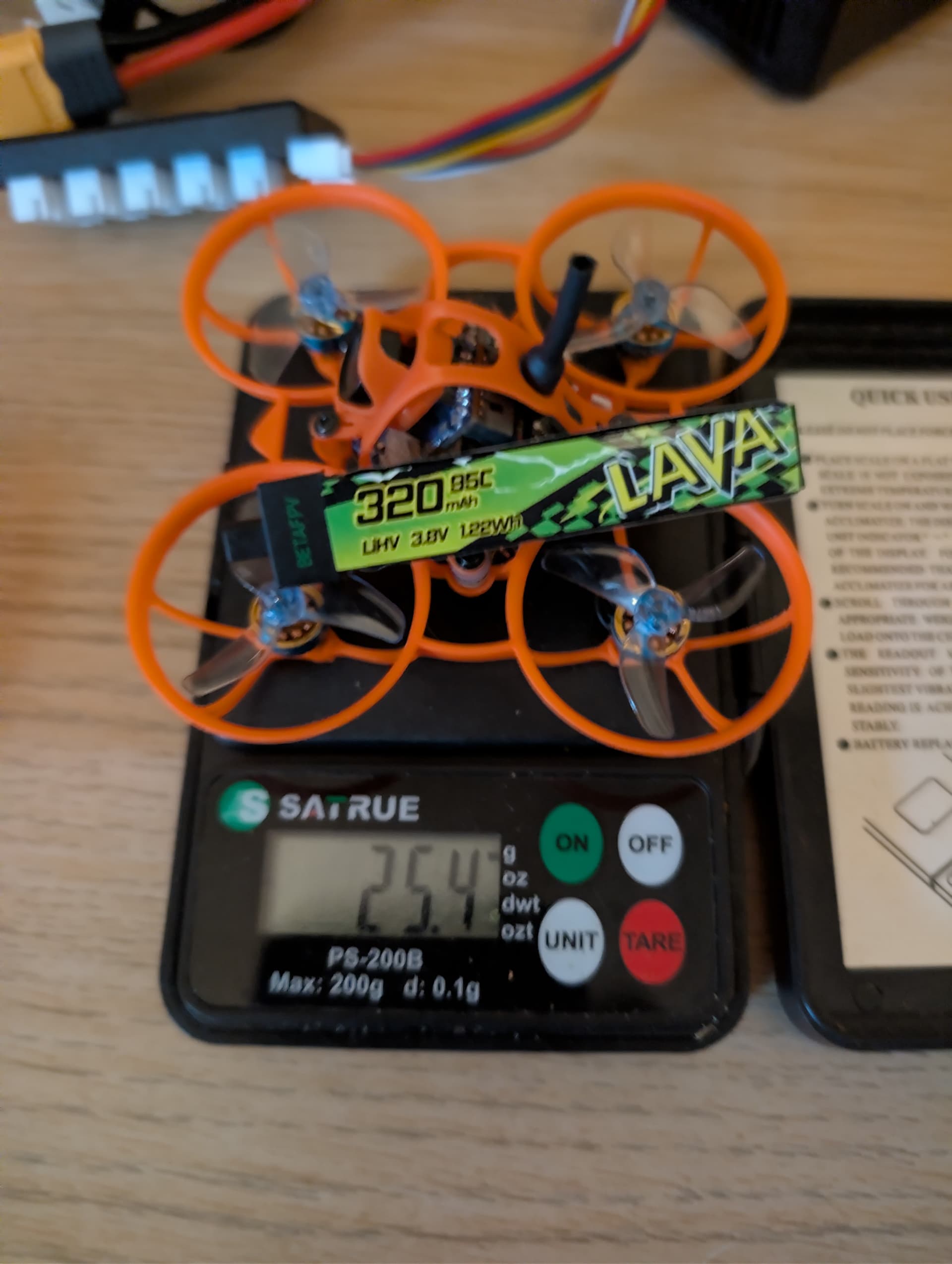

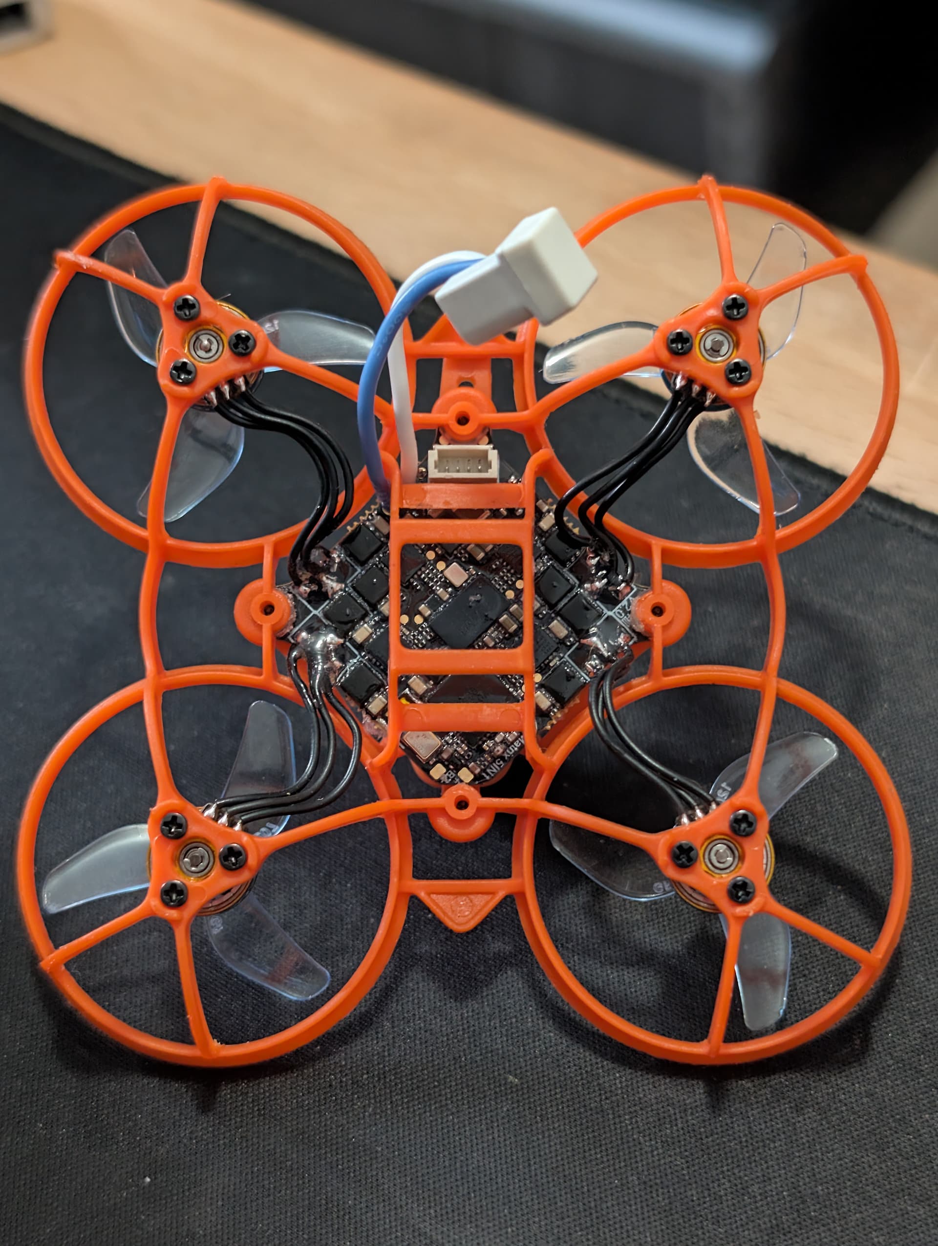

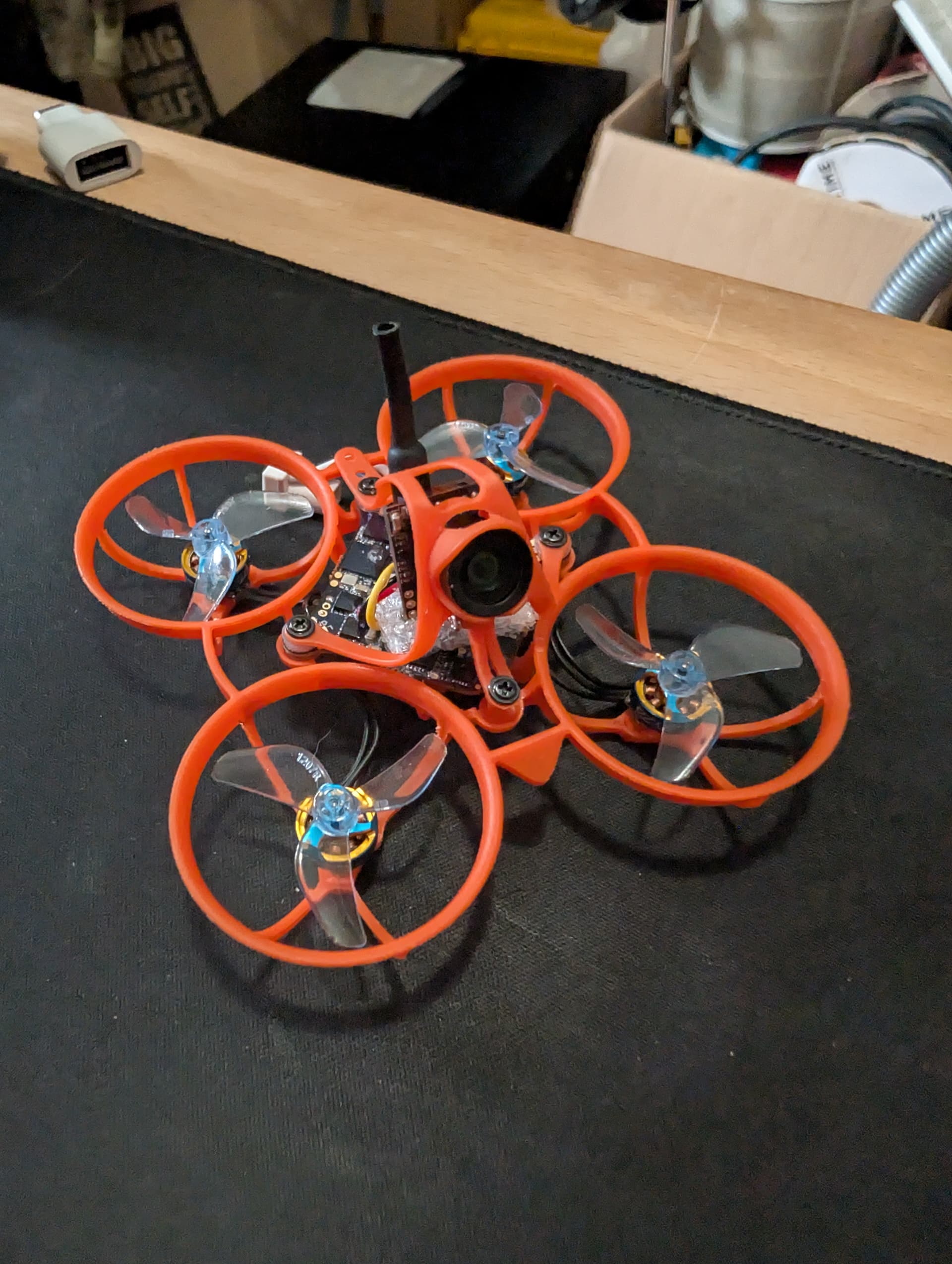

Built two the same; Matrix II AIO, CaddX Ant Lite cameras, RCinPower 0702 31800kV motors, 1209-3 props, Lava II 320mAh 1s Lipo on Air65 II frames. All wire solder joins e6000 glued, AIO and Cam PCB conformal coated with MG Chemicals 422c.
There’s a little bit more weight to be shaved off by way of removing the cameras’ sockets and soldering the cables, but I need to fiddle with camera settings before I can do that.
