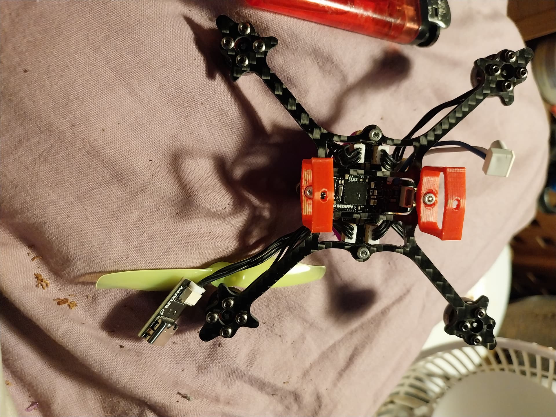

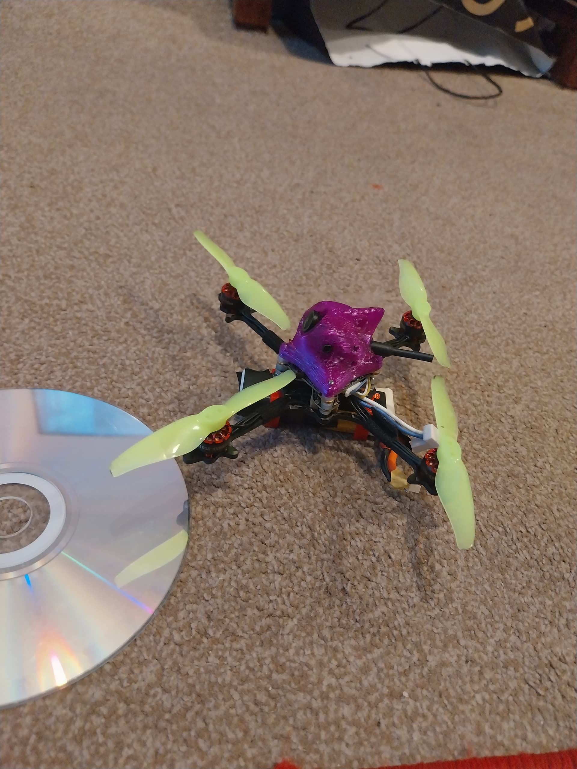

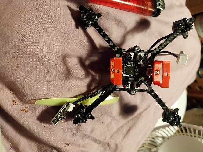

At last a short break in the weather just enough to try my new build a 3inch toothpick,.
First flight just put it on a mini
a larva 300 1s 75c and it flew for 5 mins just cruising.
Buillt two diffrent batteries to try longer flights with more aggressive flying. 2x .55 linked and a 30amp max 18650.
Processing: 1000009300.jpg…
Processing: 1000009264.jpg…
The spec:
1-2 s happy model 1103 8k motors
Gemfan 3inch props
Betafpv p1 air hd cam and vtx
Betafpv 3 in 1 hd flight controler
3inch toothpic carbon frame
Pre battery dry weight think it was 48g 68 and 78 with diffrent batteries.
