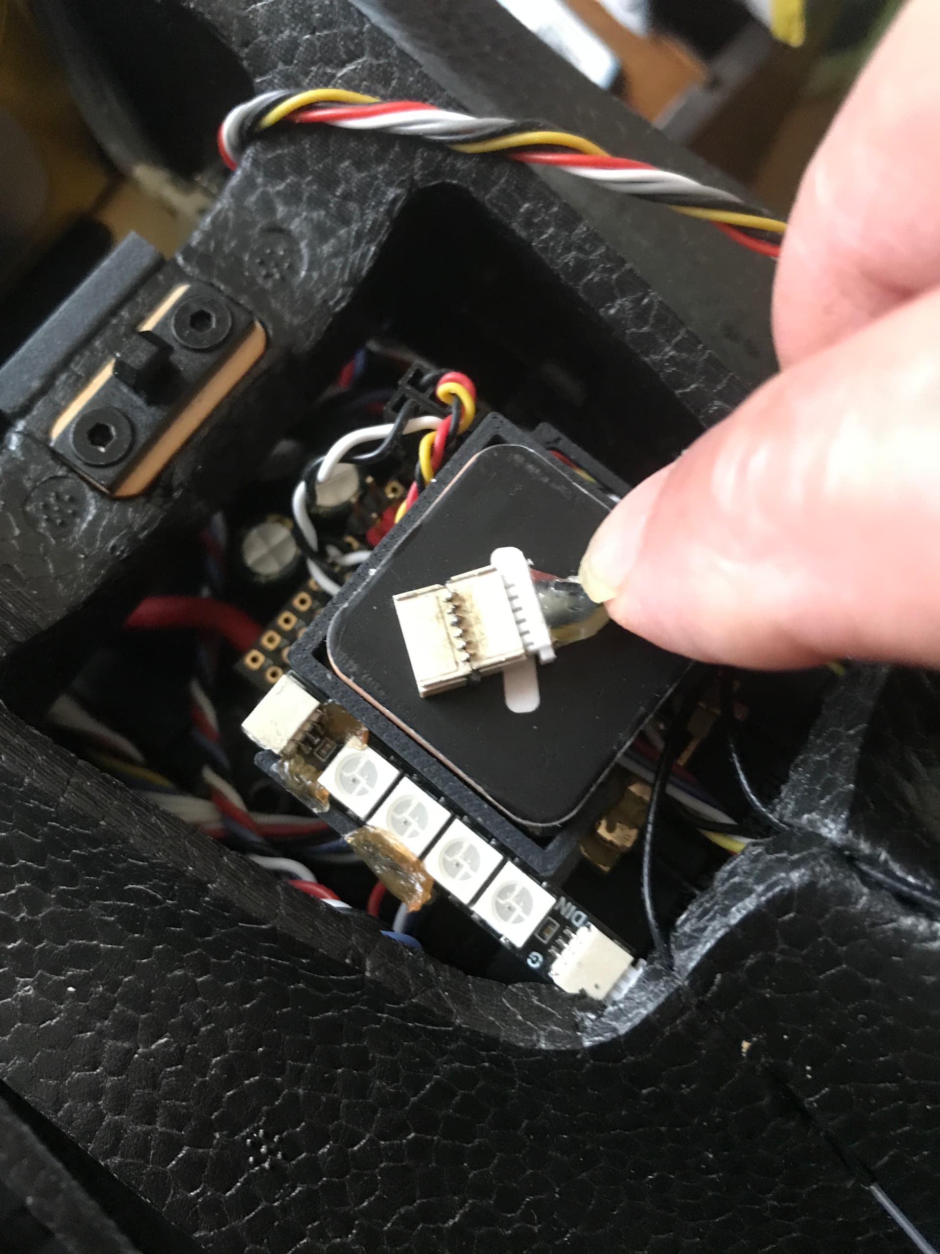

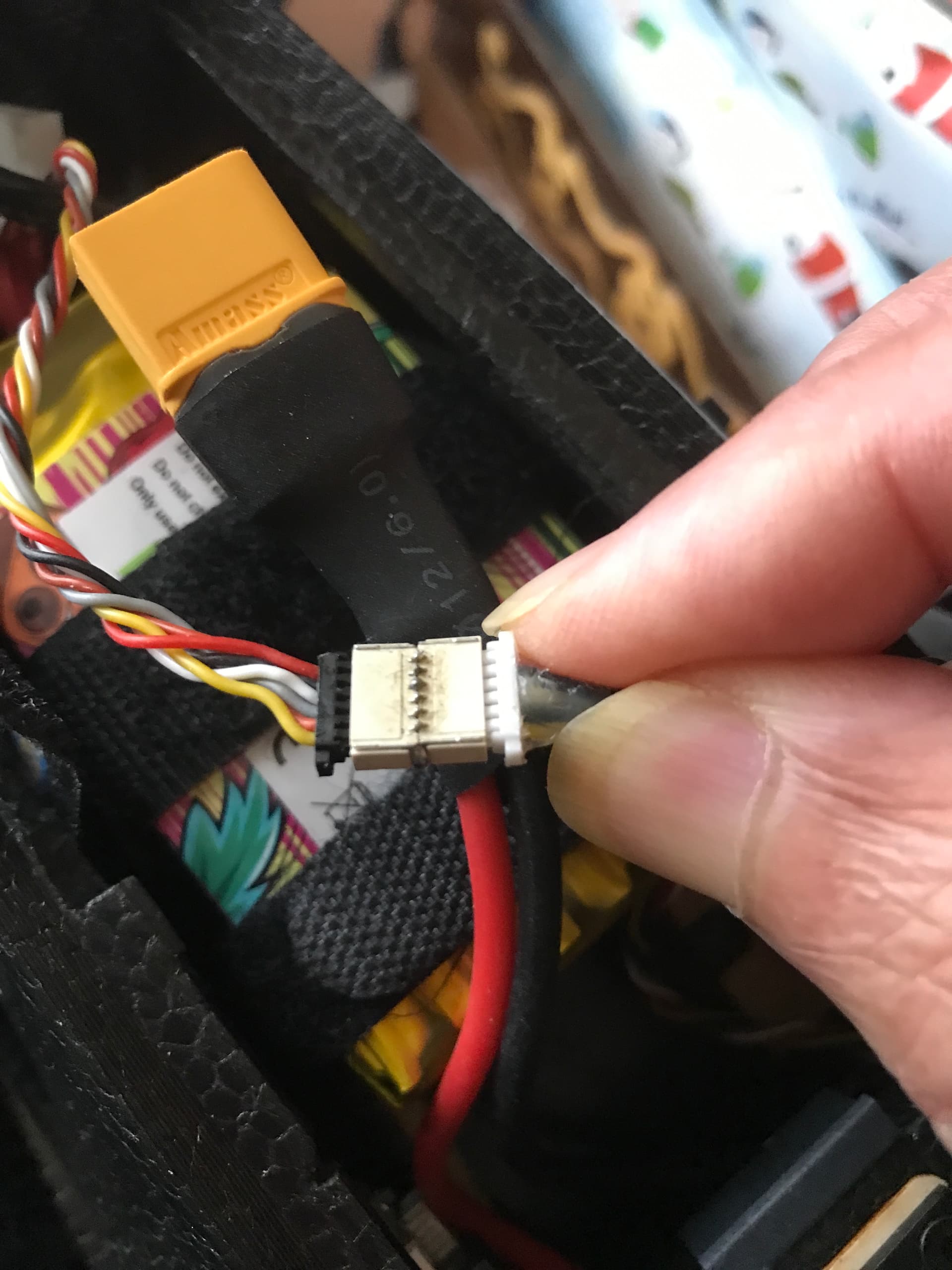

I had to solder two surface mount connectors back to back for a flight controller cable to a Dji 03 air unit cable in my TBS Chupito build. It’s less messy than a switch, so while waiting to acquiring Satellites the air unit doesn’t overheat. The trick was to wet the tip followed by just touching the pins, the wiring needs to be reversed on one of the connectors.

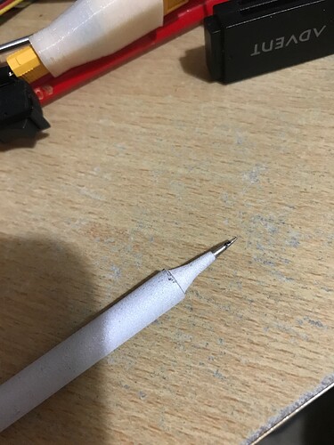

The tip
