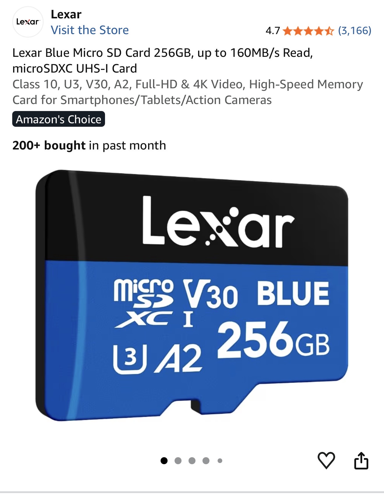

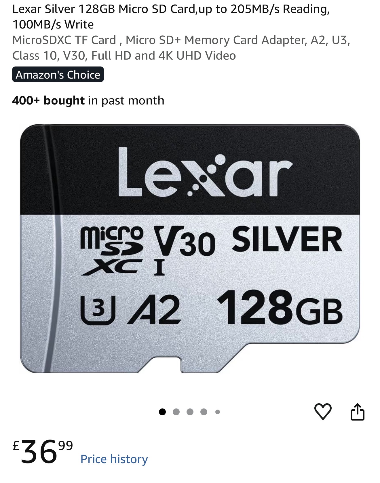

Afternoon guys,will these SD cards be ok for the mini 5 pro,the 256 in the drone & the 128 in the remote.

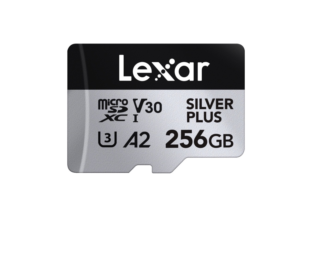

I personally use the Lexar Silver Plus micro sd cards as they have a better for Zero Dropped Frames and Drone footage records at high bitrates. The Lexar Professional Silver Plus offers a much higher write ceiling (up to 150MB/s), which acts as a safety buffer. This prevents stuttering or corrupted files if your drone spikes its recording bitrate during complex, fast-moving scenes.
DJI Compatibility: Leading drone manufacturer DJI explicitly includes the Lexar Silver Plus on its officially tested and recommended accessory list for high-end models like the Mavic, Air, and Mini series. The Blue series is left off these performance.
Faster Offloads: When you’re back from a shoot, the Silver’s 205MB/s read speeds mean you can dump hundreds of gigabytes of 4K footage onto your laptop significantly faster than you could with a Blue card.
I use only the 512gb they are expensive but i have used them for years with no problems with footage.
Hi, you can also use the scandisk extrame in your mini 5 also recommended by DJI, SD cards are expensive again but you really do get what you pay for and there are a lot of cheap fakes out there also you are looking for a card with the following
specifications UHS-I, A2, U3, V30, Class 10, 4K UHD microSDXC, this spec allows you to record in real time up to UHD without glitches or issues.

Having a few drones in my opinion as long as you stick with the A2 class you will be fine.
Unsure if you can have a u3 or bucket 3, that’s the three symbol lol, without it being A2, so any A2 will also have the ‘3’ afaik
