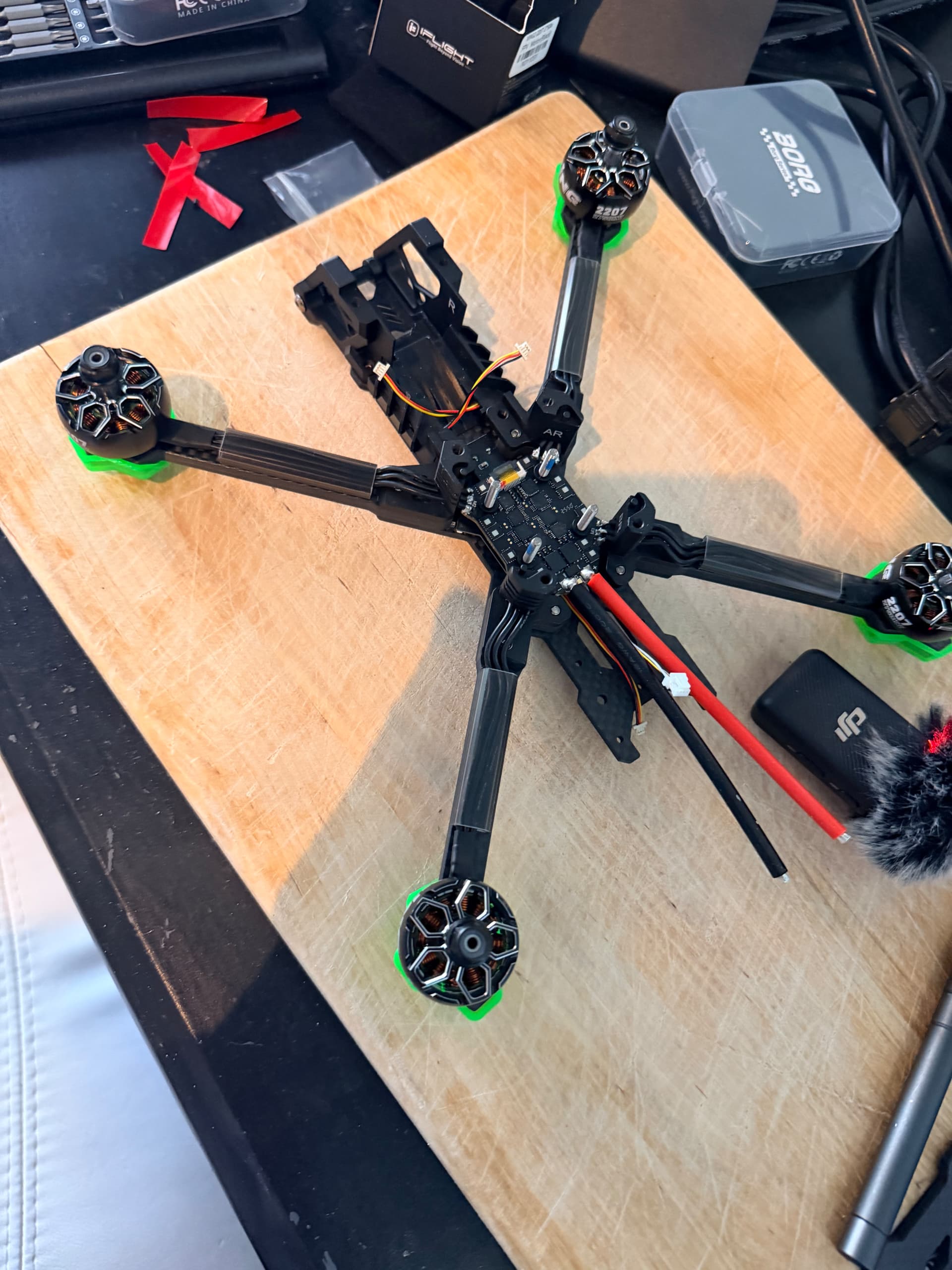

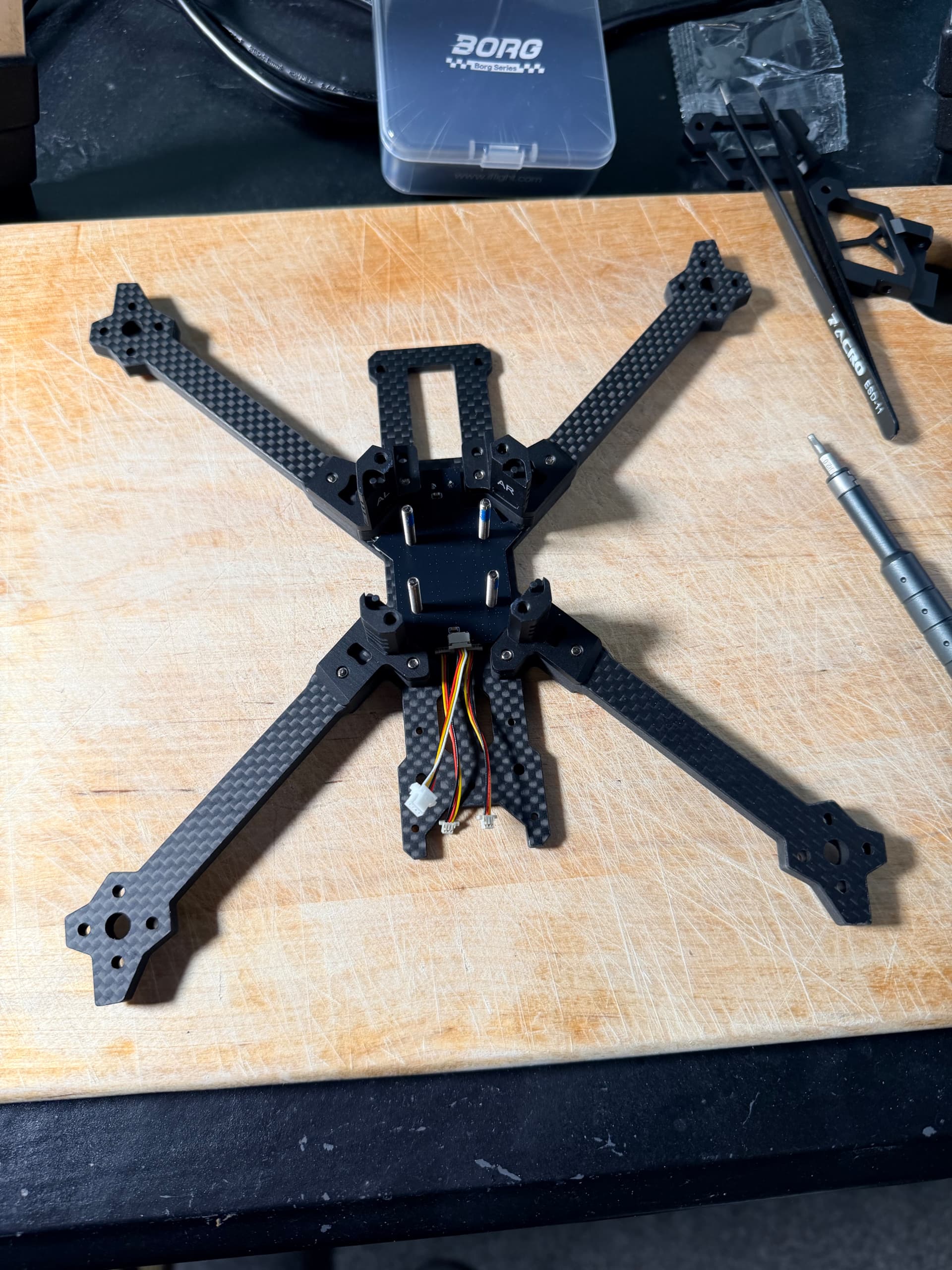

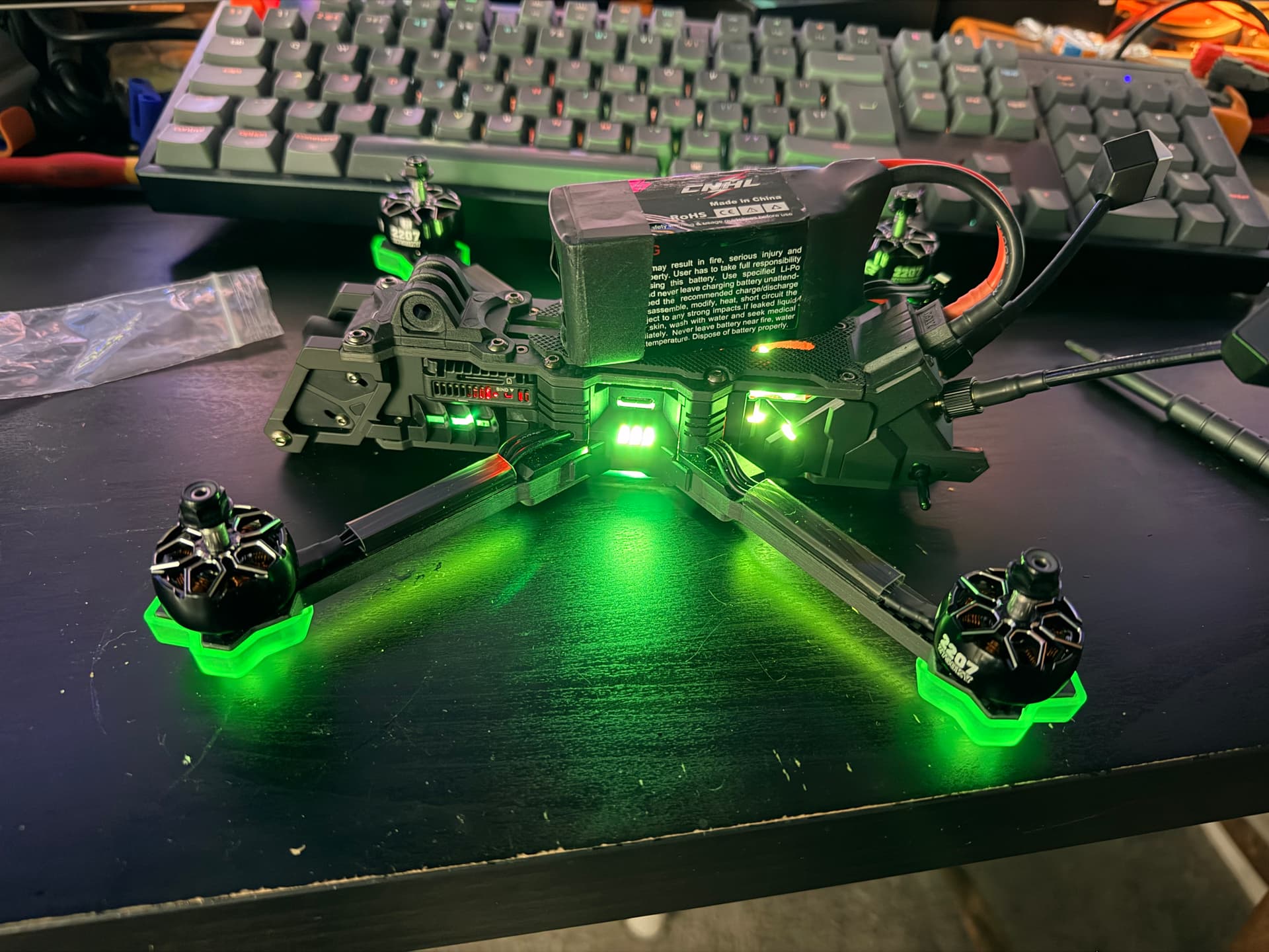

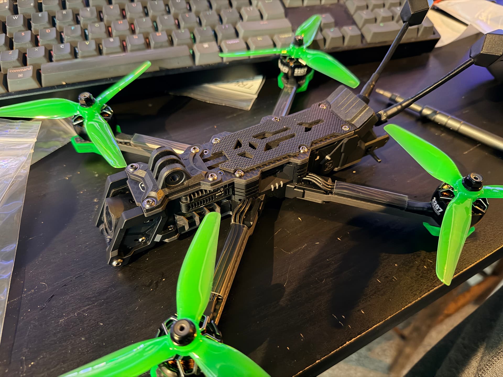

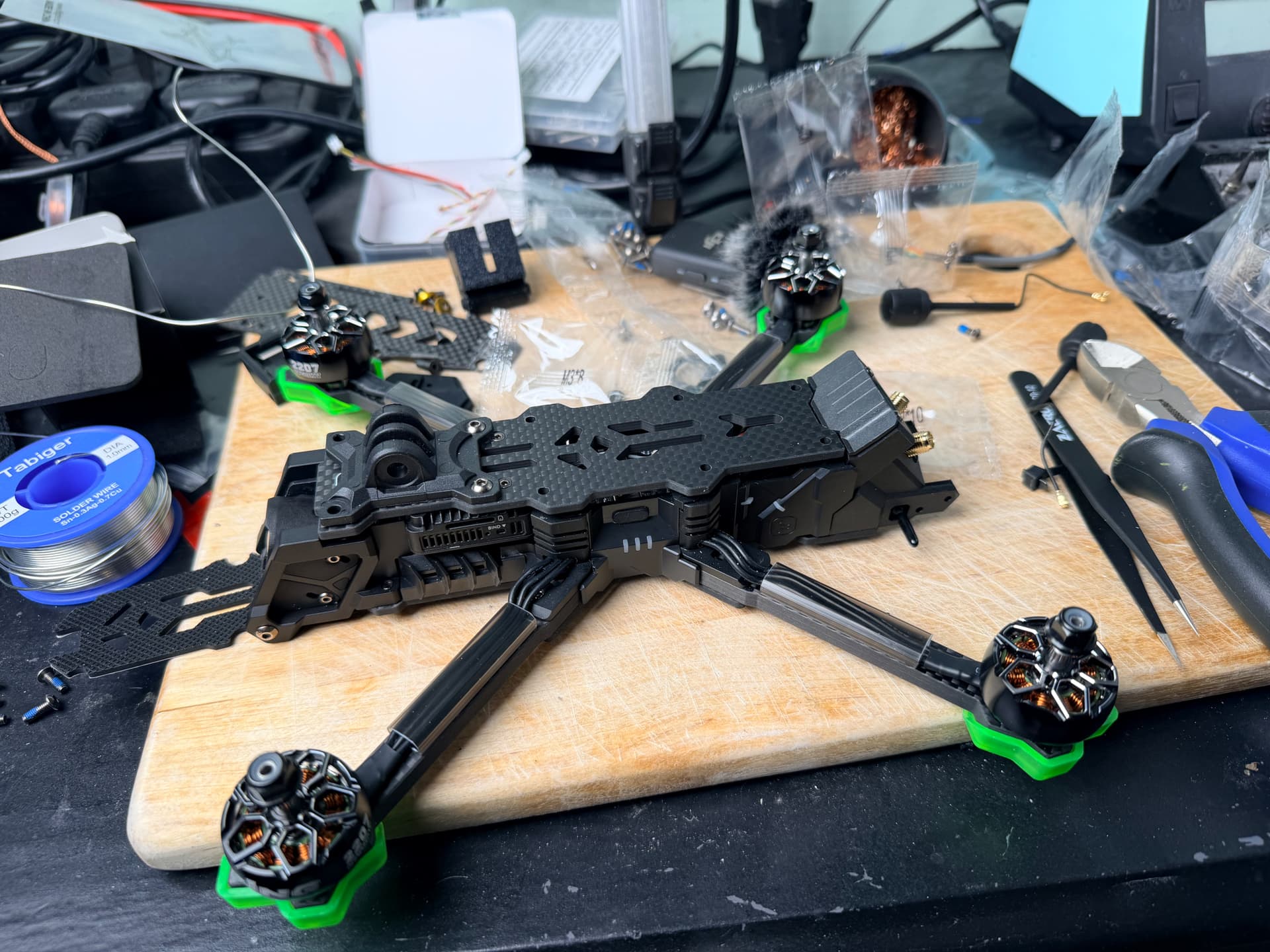

Just finished building another one, but this time I’m keeping it :slightly_smiling_face:
iFlight Nazgul Evoque F5 V3 frame, with mostly the same equipment as you get if you buy the BnF, except I’ve gone with 2750KV motors because I want to run it on 4S (I have a lot of 4S batteries and only one 6S).
It’s a really nice frame, a bit quirky in places, so it took the best part of a day to get it together. It’s got the new DJI O4 Pro I got the other week (to replace the one I crashed and ripped the antenna connectors off - great service from DJI, brand new air unit for 30 euro!) and is replacing an old TBS frame I’ve crashed to the point where it was held together with zip ties an good intentions :sweat_smile:
Overall very happy with this one. I did buy the wrong stack initially so I’ve now got a full-size Borg RX stack in the drawer for a future build, but after getting the mini stack and waiting a couple of days for that to arrive, it’s all built and tested. Next up will be betaflight config then some tuning :slightly_smiling_face:
