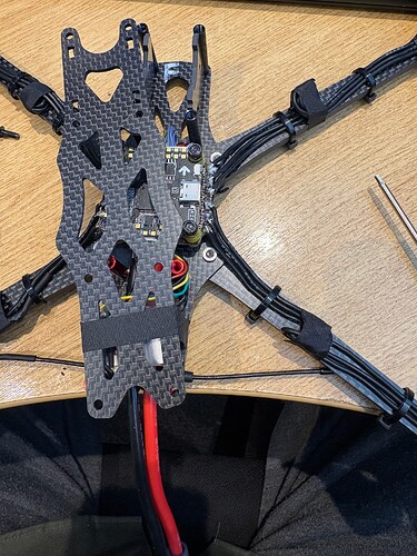

Can you send me a picture of the FC in the frame?
yep, It’s pointing the right way, if that’s what you want to check… Notice the Arrow and the ‘F’ in front of the camera mounting side plates
