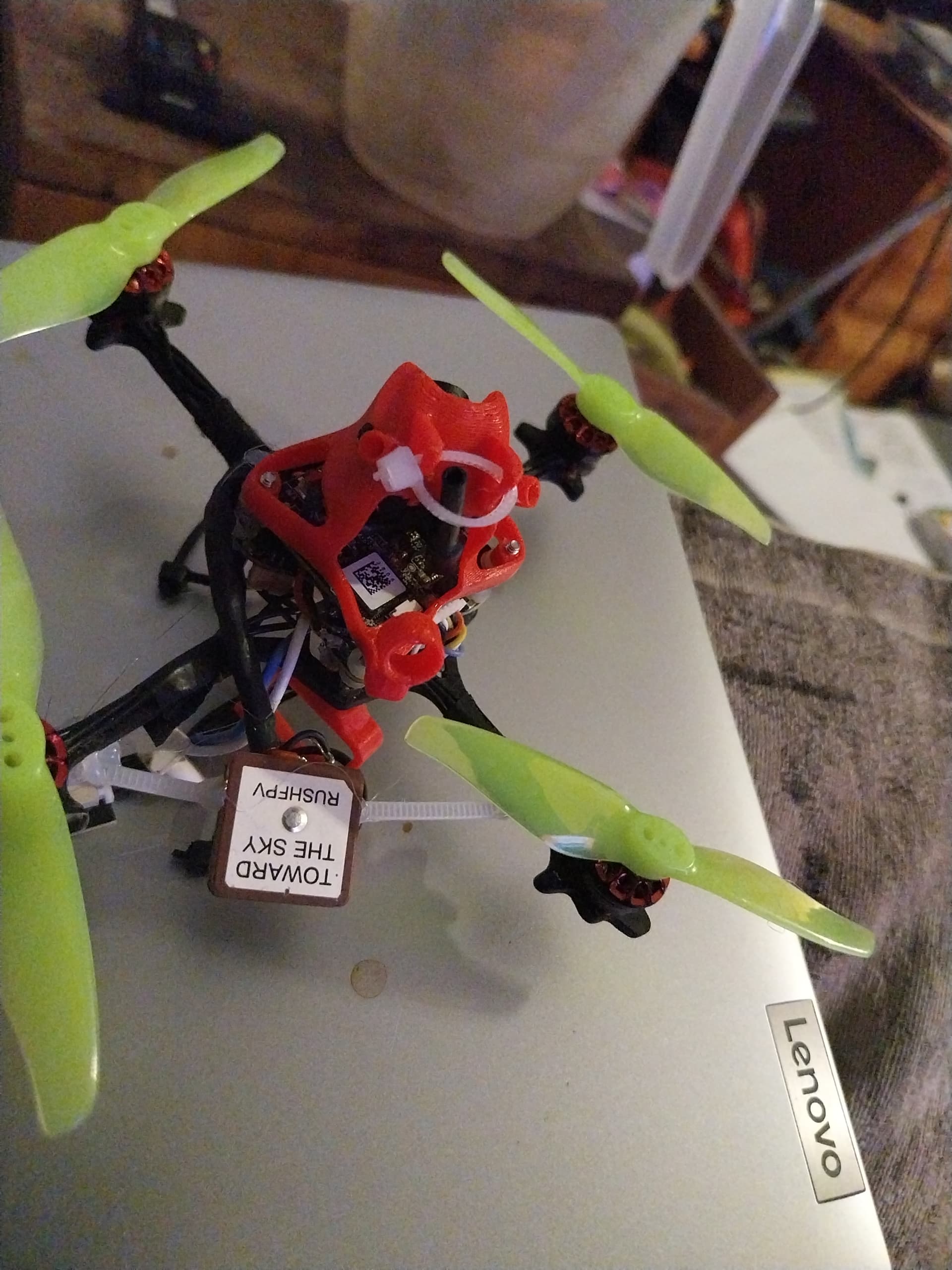

Took my Toothpick to another level!
Sun out today (somewhat) been waiting to trial gps return to home.
Some success and failure all at the same time.
Ĥad to double sheild as so small distançe to anttenas.
Testing at home only getting 6 locks on satalits, so set minimum to 6, this was a 4metre lock to my actual location.
Hot glued a part of zip tie accross arms at the back and then hot gluded gps to that.
In the field amazingly 15 locks in 1 min.
So procedded to fly off and do first testing, radio self test …ready to hit that button, when suddenley for no apparent reason I had real RX loss.
On screen activation of gps rescue flashes
But no rescue.
Dident have the correct hover rate set or max rpm as forgot I changed to a twice the weight battery, so it basicly started to fly back by raising up, but there was a wind and it could not compensate enough. Slowly sank to the ground.
Oh well was a fun afternoon.
Back to the drawing board?
Yes do some testing for hover rate on new batteries and go again, the mere fact it started to do as expected was intoxicating.
