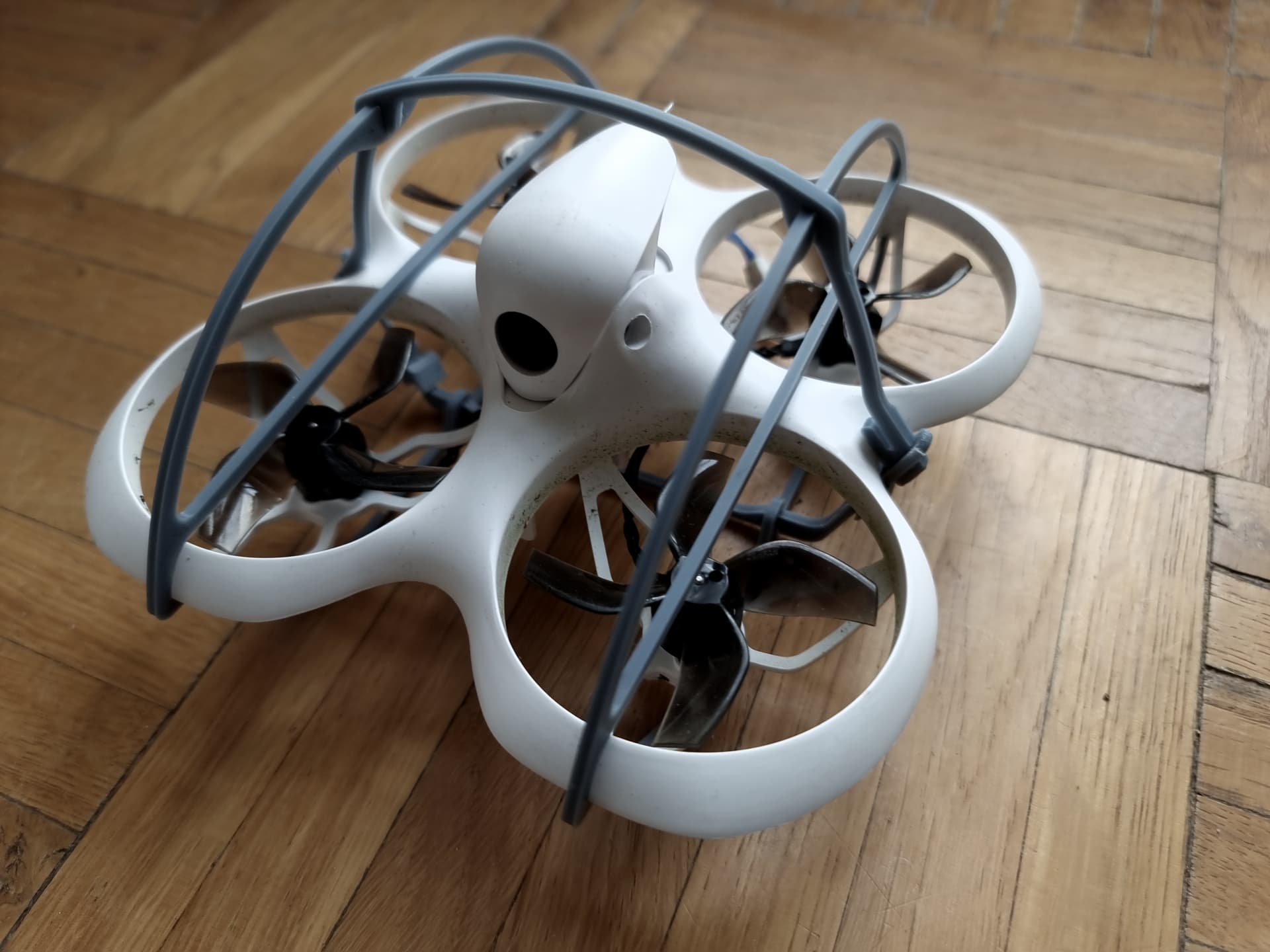

The Cetus X is widely recommended as a good value training drone, but I’ve found it generally hard to fly. The motors and tuning mean that it needs a big space to fly, which means having to tow an unwilling spotter. It is far too jumpy for indoor flying and is very prone to losing props as they’re just pressed in. And of course it’s analogue, which is the opposite of future-proof.
I’ve changed the PID and throttle settings a few times but I think 2S is probably just too much power.
I found this cage on Makerworld and it has helped a lot. I never lose props now, crashes don’t damage the drone and I haven’t noticed any difference in performance.
Even better, the design takes very little filament, prints in half an hour and works with my cheapskate PLA. Oh, and the interlocking design is easy to assemble, gives access to the batteries and has just enough flex to give a nice bounce.
Sadly it doesn’t stop impacts from shifting the poorly designed camera mount - but 9/10 is not bad.
If you’re attracted by the cheapness of this drone kit (available for as little as £150 on eBay with an acceptable controller and goggles) then it might be of interest.
Get the STL here:
https://makerworld.com/en/models/1070886-betafpv-cetus-x-camera-protection-frame?from=search#profileId-1651487
