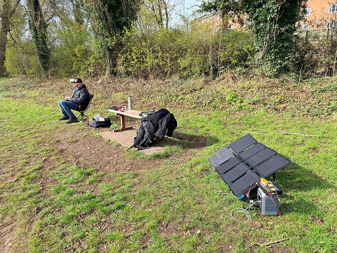

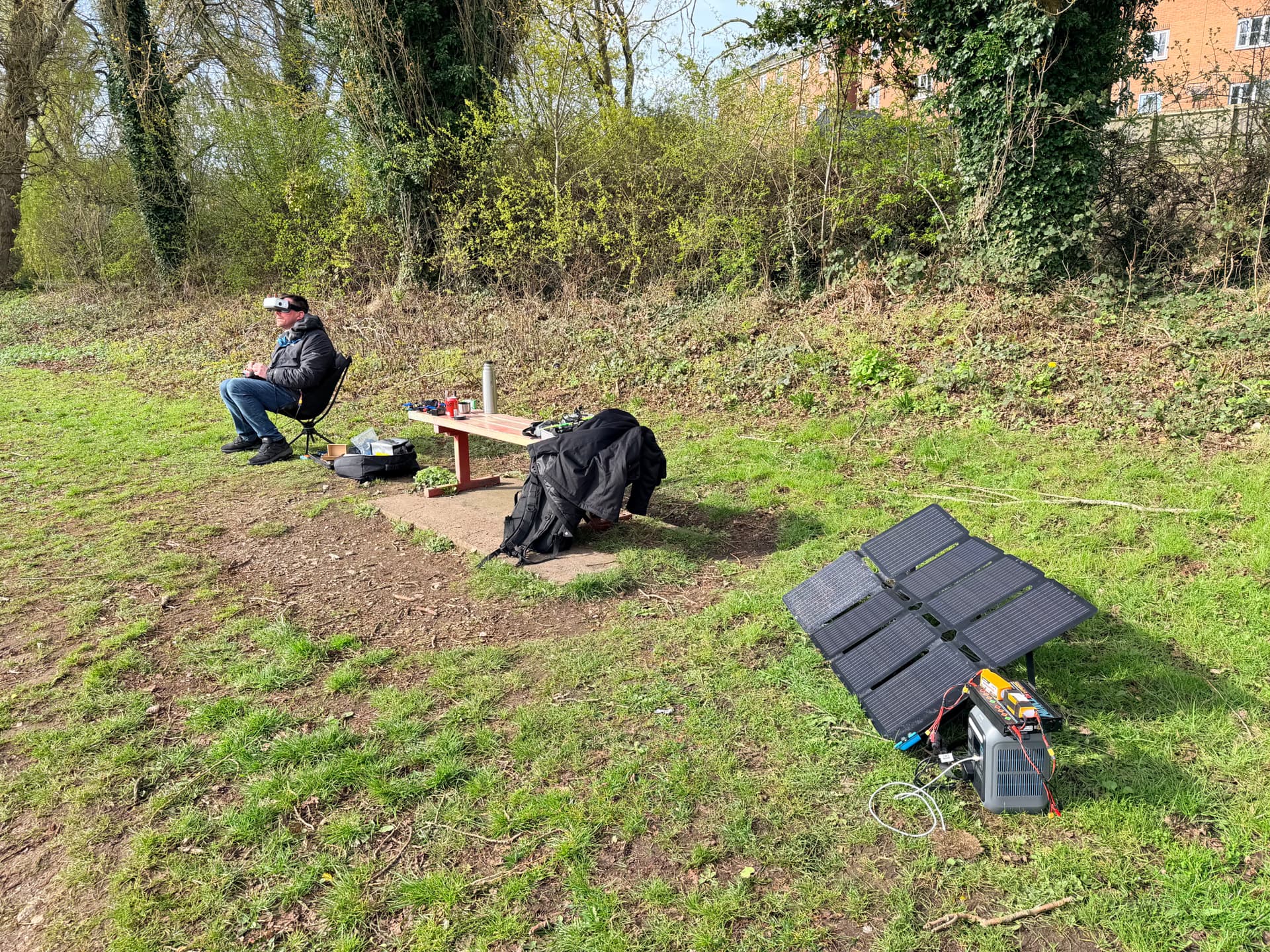

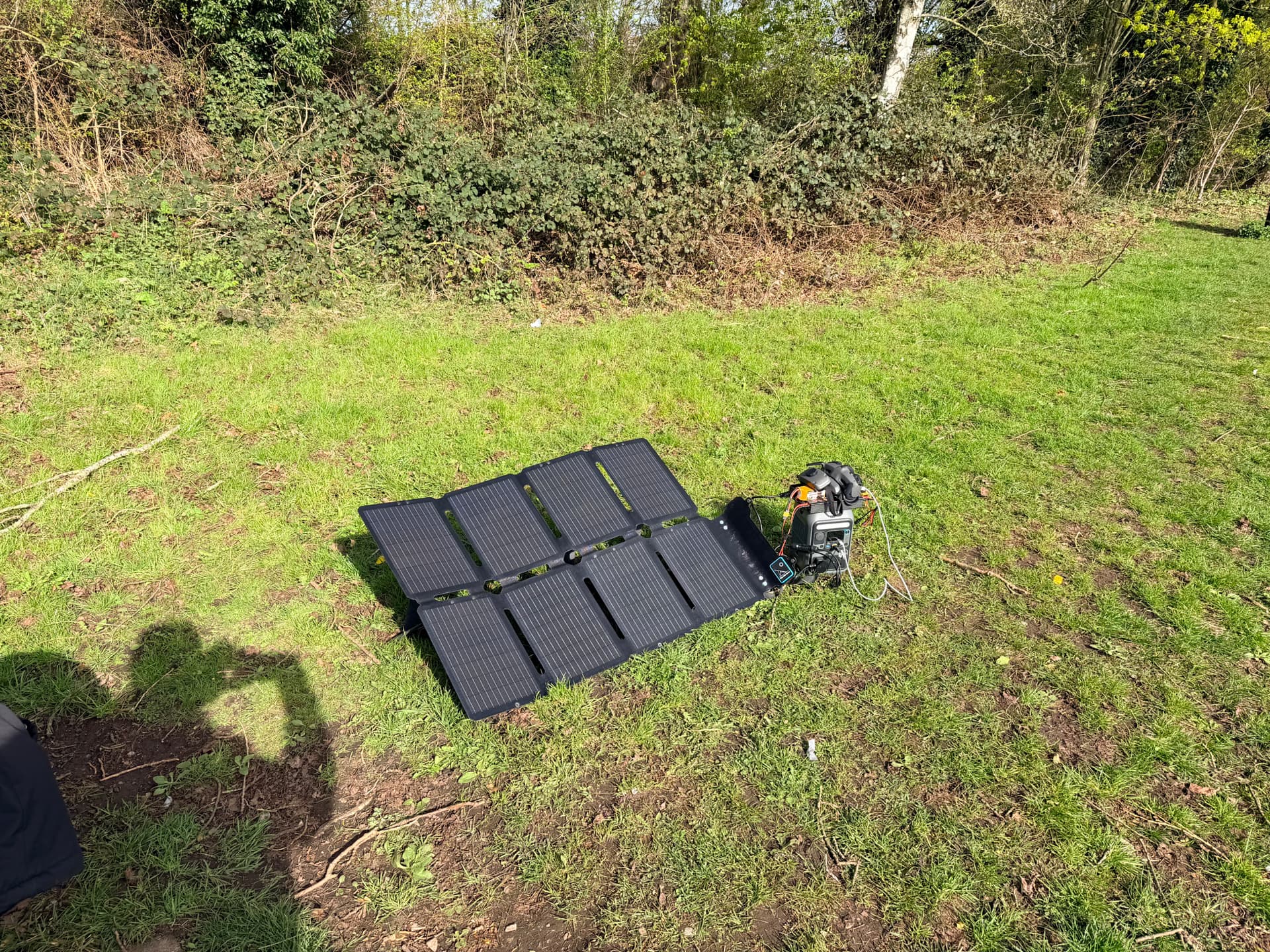

It’s been a beautiful day here today, so decided to go and get some stick time in. I recently bought an Anker Solix C300 and a solar panel (in what seemed like hopeless optimism at the time :sweat_smile:) and finally had chance to try it out today - and I’m super impressed.
Took it out at 76% battery, was our from half seven this morning until one this afternoon, only had six packs with me and was able to keep the drone in the air pretty much the whole time I was out by just cycling the batteries through my two-channel charger plugged into the power bank as they were used up. After five and a half hours, then power bank was sitting at 71% thanks to the pass through solar and top-up charge in between charging the packs.
Really impressed with this thing, if anyone’s been thinking of getting something like this, I definitely recommend going for it. I could have stayed there literally all day if only I hadn’t been called back to my chores :sweat_smile:

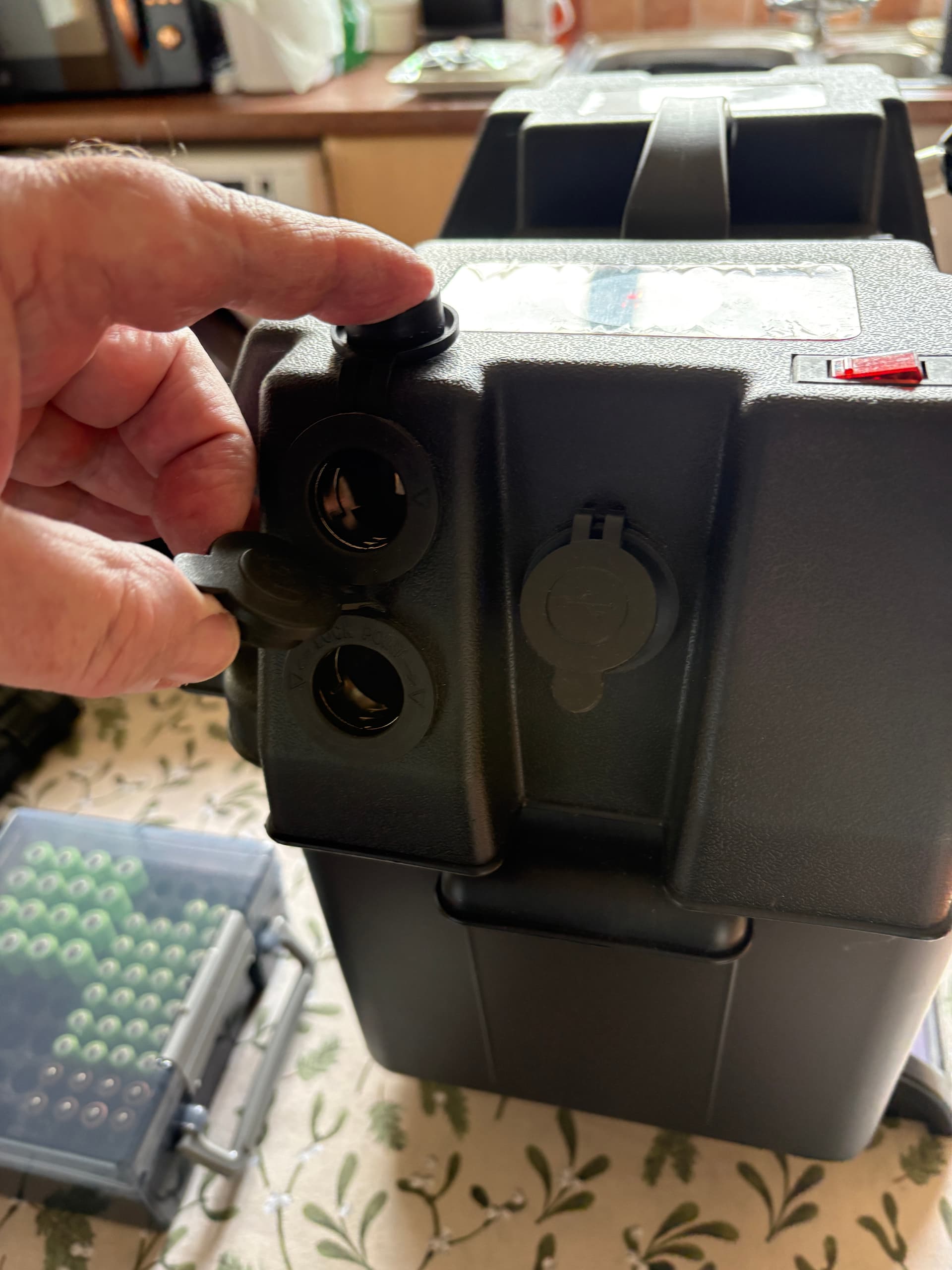

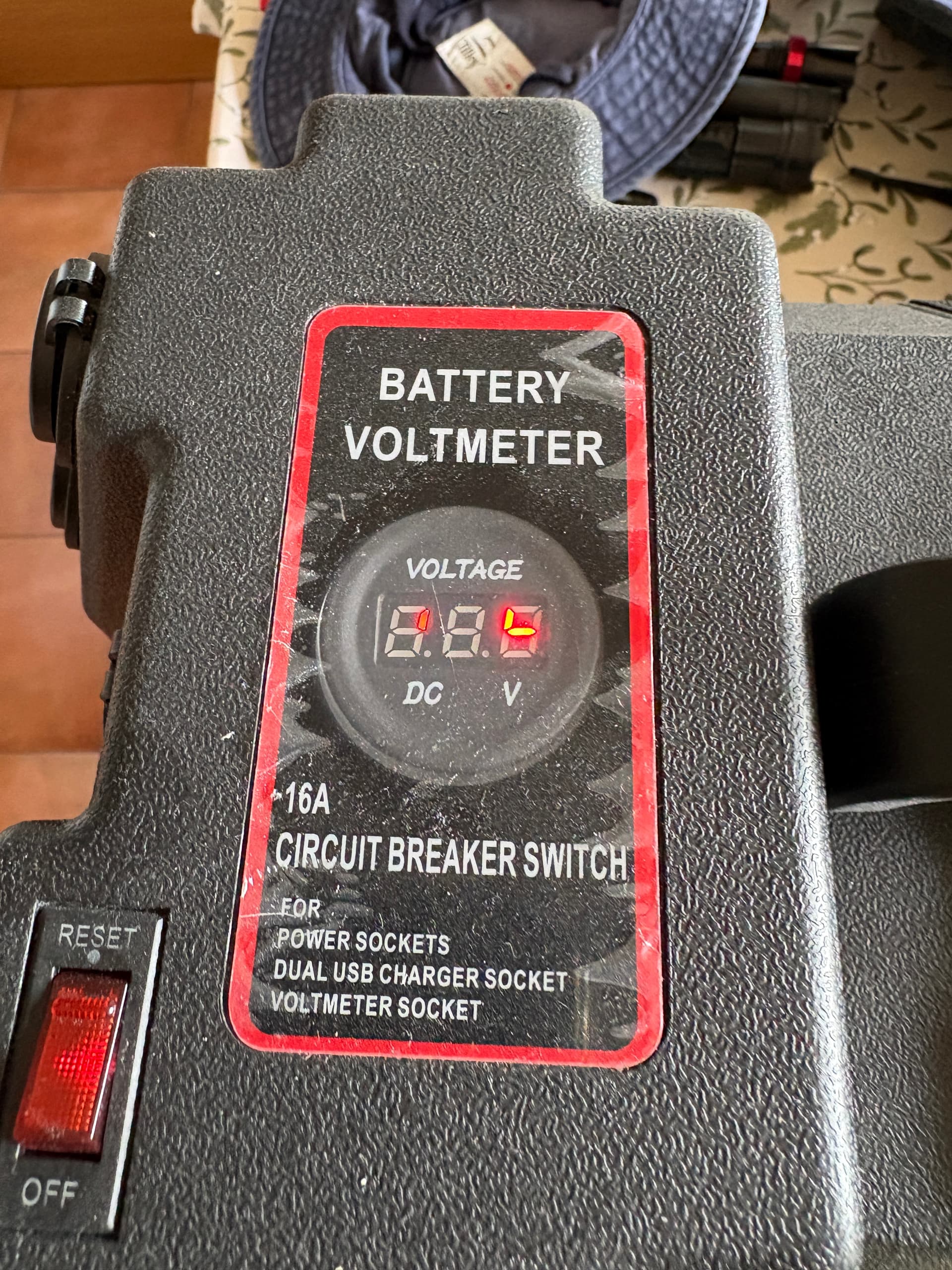

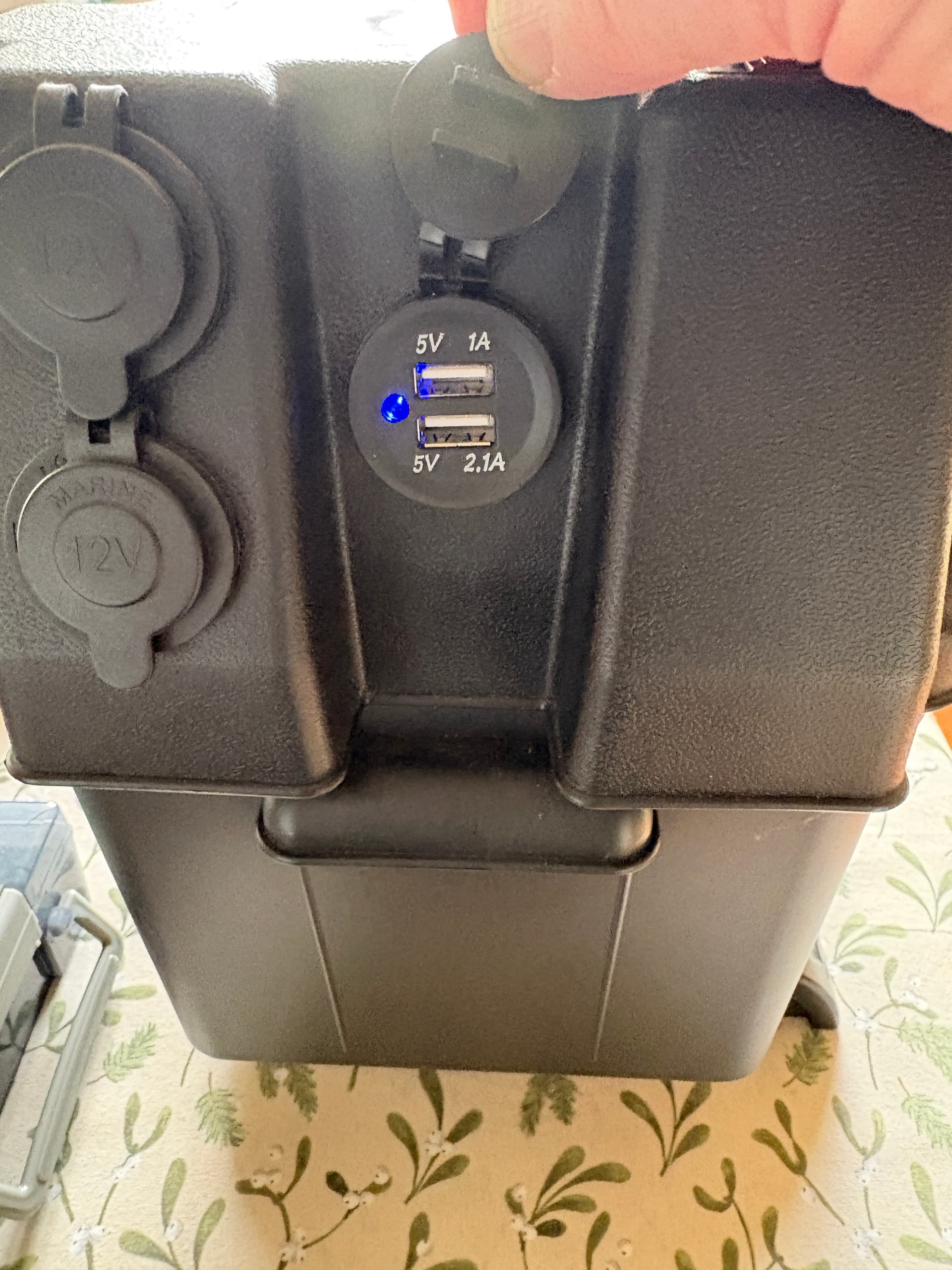

I put one together D-I-Y style, ordered the following:
100 amp hour LiPo battery
Battery box with USB 12volt and direct connection
Installed into the battery box, all done! Loads less than the DJI or the C300. For 240v I have a couple of small Inverters, I can fast charge batteries for my current DJI Mini 3 in no time at all with a big RPi mains charger. Works very well and saved me loads of cash. Just looking for some solar panels to keep it topped up for long days, but with 4 batteries for the mini 3, it’s not too much of an issue.
BackUp is a small 50 Amp hour LiPo, but I don’t use that much, so I’m thinking of selling it.
Edit - Not sure of the weight, will have to check and add it here…
Nice one! 100,000mAh LiPo sounds… kinda scary, not gonna lie. What’re you using as BMS for charging that?
Also interested to hear about the weight… :thinking:
Apologies, I haven’t got round to weighing it as yet…
I charge it with a smart charger with a LiFePo4 option. There is a built-in BMS, it works really well. The box/case/housing has an isolator switch and volt meter making it easy to keep an eye on the current state of the battery.
I’ll try to get it weighed over what’s left of the weekend…

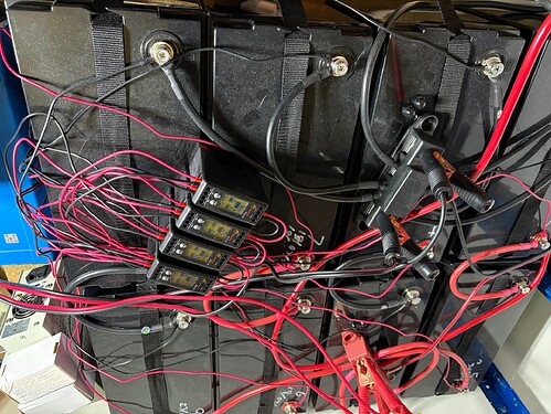

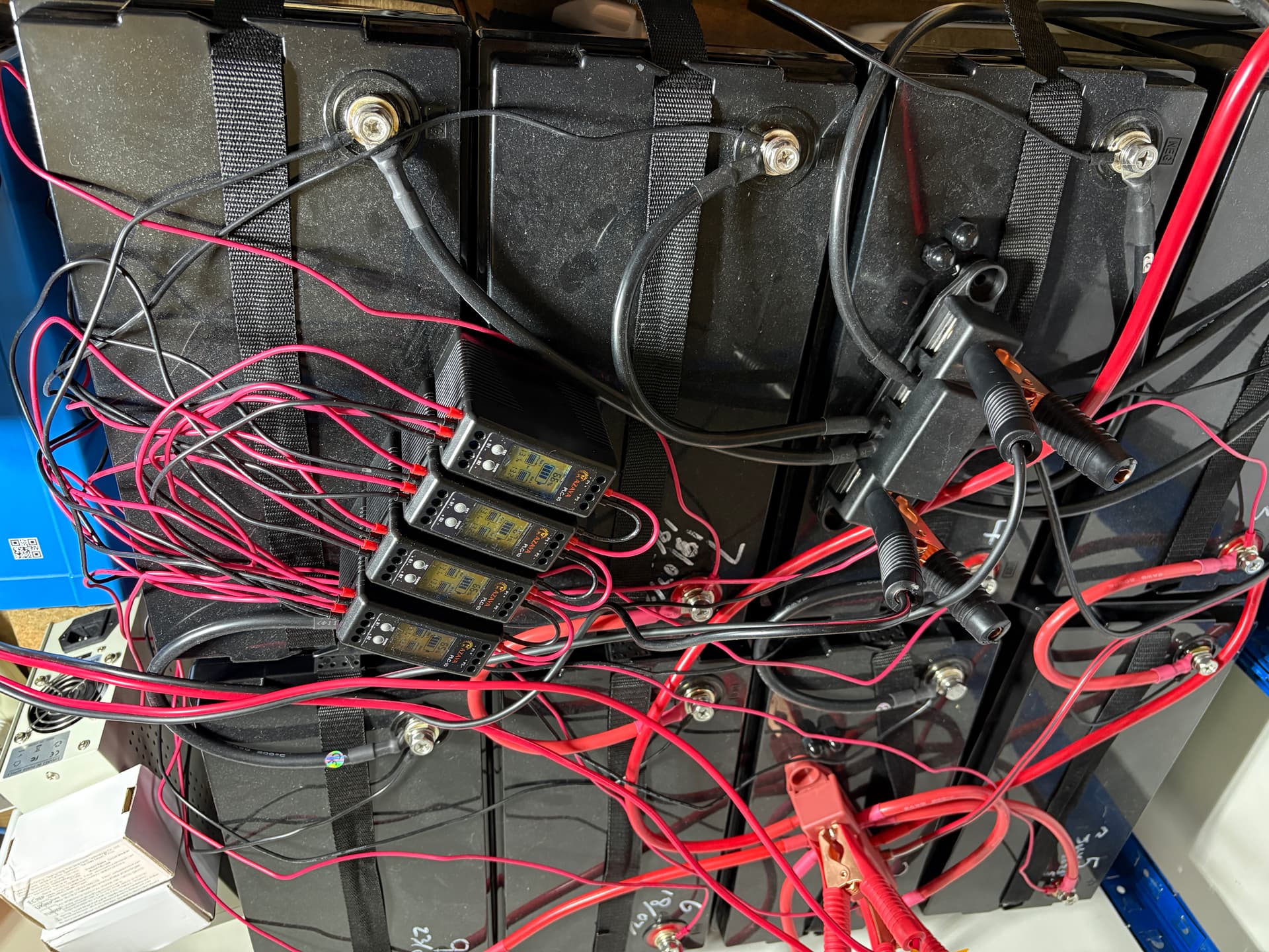

Now, these are a different story! They are connected to 2 solar chargers which each have 2 x 405 watt panels charging them. The little gadgets balance the 12 + 12V = 24 volt banks, but they are all connected together and balance left to right as well as up and down.
I have some fuses and trip switches between each stage and some fuses going on each battery this week, to protect against battery faults or big spikes.
BTW - they are the same 100 amp hour batteries!

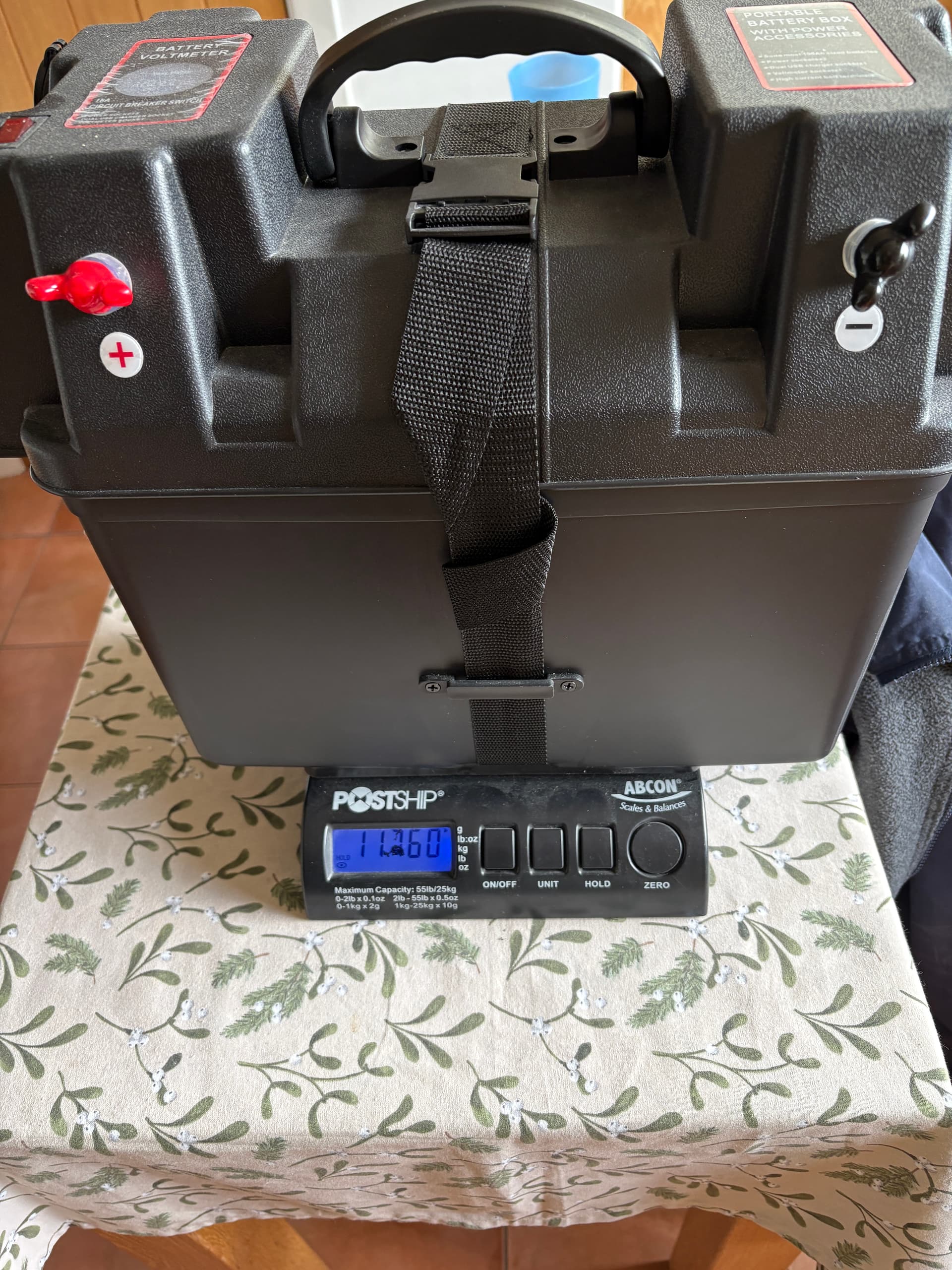

EDIT/UPDATE - Weight 11.76Kg - not as heavy as I thought!
Some Pics of the connectors etc:
See what you mean…
