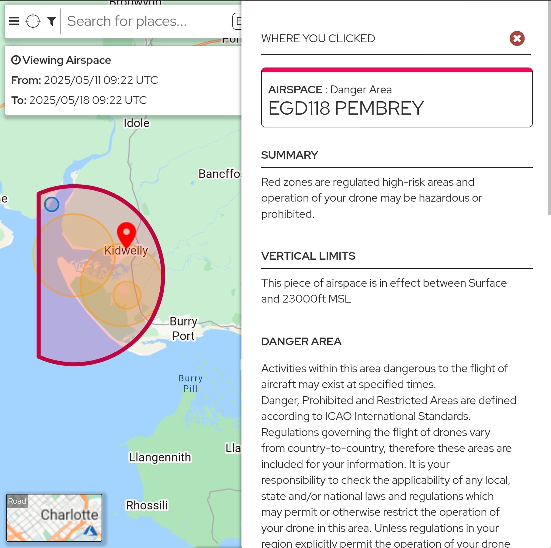

Can you tell me what this means?
Can I fly here in the circles or its a no?
Why?
Thanks
Click on them and their description appears in the right hand column.
Yellow is generally ‘An area of increased risk’. It will explain why that risk is increased, in the right hand column.
The red area is generally an area that you can not fly in. Such as an FRZ. It will explain what it is, and why you can’t fly there, in the right hand column.
All the best
Simon
EGD118 Pembrey Danger Area.
My understanding is that, unlike a prohibited or a restricted area, a danger area is not actually forbidden to aircraft. It is just that what is going on in there may put your aircraft at risk.
It is only active Monday to Thursday 8am until 4pm and Fridays 8am until 2pm.
You can contact the range ATC on 01554 892205.
