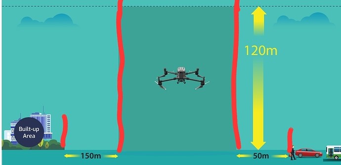

As you can see in http://FPV.uk/openinfog your aircraft would fall under A3 - Fly far from people.
This requires that the aircraft remains at least 150 metres horizontally from a built-up area.
Article 16 does not allow you to fly in a built-up area, except where it is an area used only for recreational purposes (e.g. a park), and you do a risk assessment.
You can’t fly over people at 50m. In A3 you must maintain at least 50m horizontal distance. You can’t overfly people in A3.
The take-off distance doesn’t really make any difference. You must always keep the drone 50m horizontally from uninvolved people, and 150m horizontally from a built-up area.

No, it is 50m horizontal distance. You could never be over someone and also 50m horizontally from them.
In A3 you can’t ever be closer than 150m horizontally to a built-up area, nor 50m horizontally from an uninvolved person.
Height doesn’t make any difference.
Imagine an 80,000ft wall 50m from an uninvolved person, and the same 150 metres from a built-up area.
