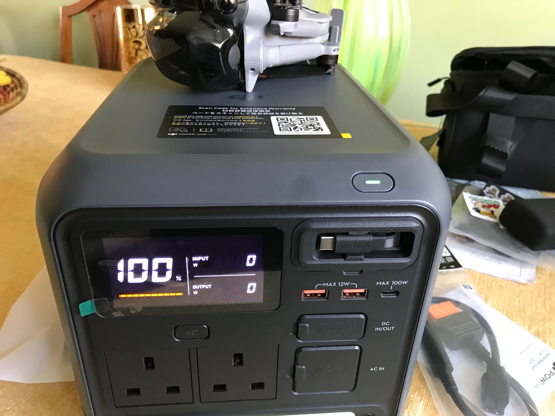

I’d been contemplating on a field charger for far too long but finally bit the bullet.
The new Dji 1000 Min.

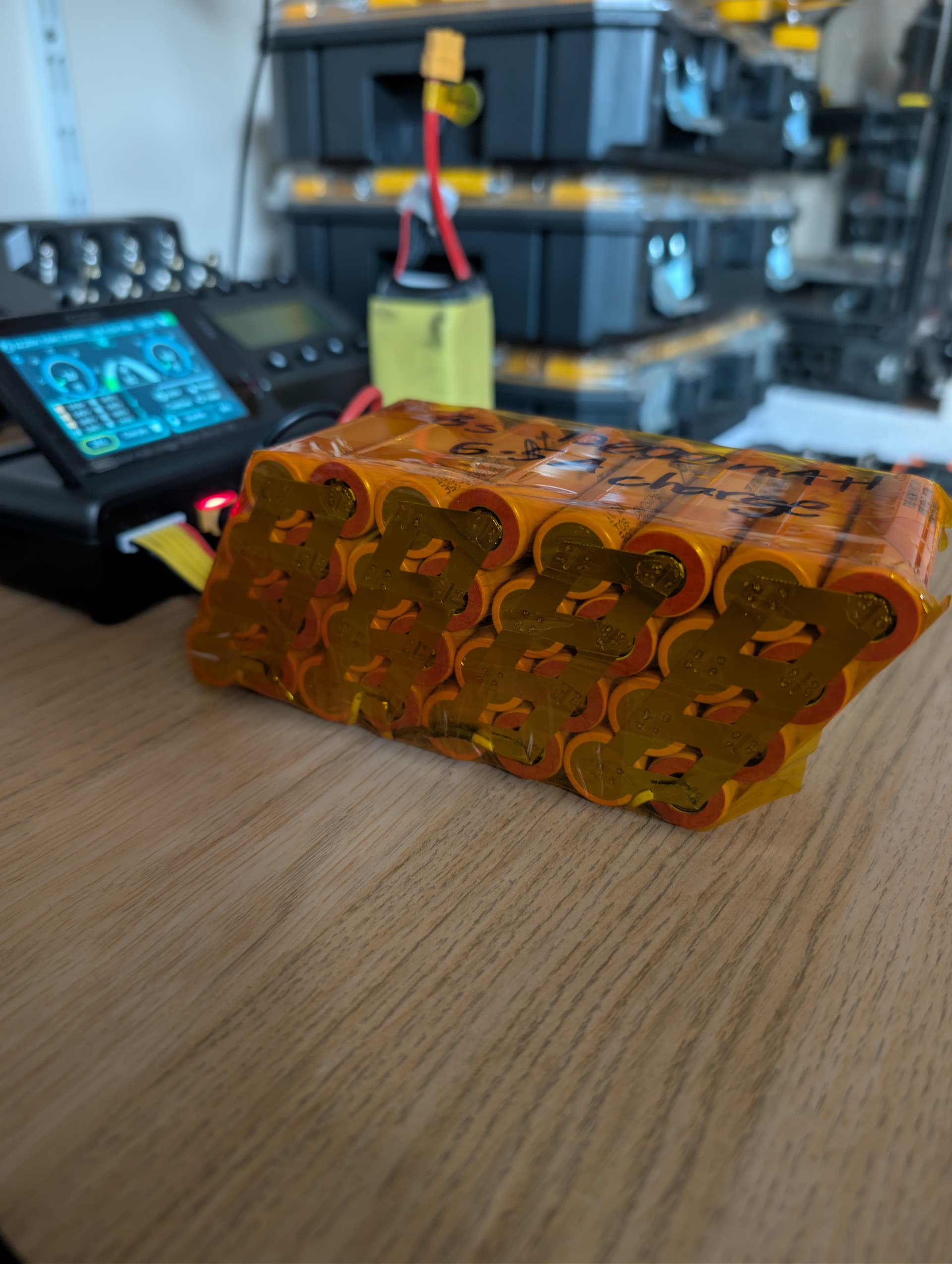

I built an 8s4p pack from 18650 cells to power my charger in the field. It’s an 8s charger which is powered by a converted ATX PC PSU at home. That means the field pack requires no BMS as it is balance charged by the charger.
Using 4 high capacity (but relatively low discharge rate) 18650s in parallel for each element means the pack has about 15 full charges of my typical 5" packs (1400mAh 6s LiPo).
(A full charge implies charging a pack from stone dead to full. However, they’re kept at storage charge, and I don’t tend to fully discharge a pack in a flight either.)
There’s a pic of one of them before it got it’s final wrap. I’ve made a few at this point, from whatever decent cells I could get cheap. People I fly with keep wanting to buy em :joy:
