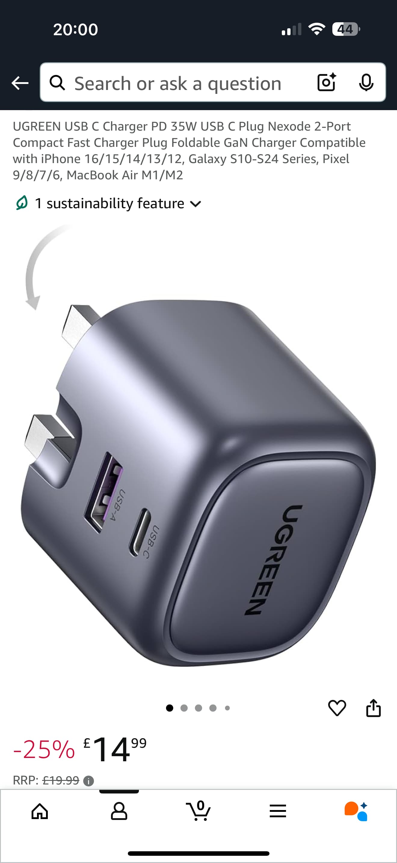

Hi there.
What type of chargers are you using? You need a charger that a provide at least 30W. If you’re just using any old phone charger that you have lying around that will cause the slow charging problem you’re having.
I use this.

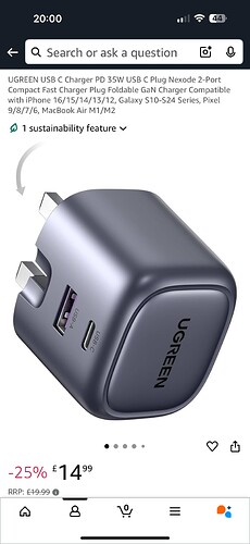

I’d suspect the USB charger you’re using either not giving enough power or not succesfuly arbitrating the correct charge rate with the 3 battery DJI charge unit. I use one of these and the charge times are under half those your quoting.

Out of curiosity I looked up the Ziwodiv 40W 8-Port Multi USB Charger Station. It’s your problem !
Although rated at 40W total it can only supply 2.4 Amps maximum per channel. That’s 12 W maximum at 5V on a single channel.
Get one of the linked chargers above and you’ll be fine.

I will order on of the linked chargers.
Make sure you use a USB type C to type C lead between the charger and DJI unit for maximum charge rate. Type A to C will be slower.
Get a lead that states it’s for charging. They have heavier wires and dont restrict the charge.
Something like this:
