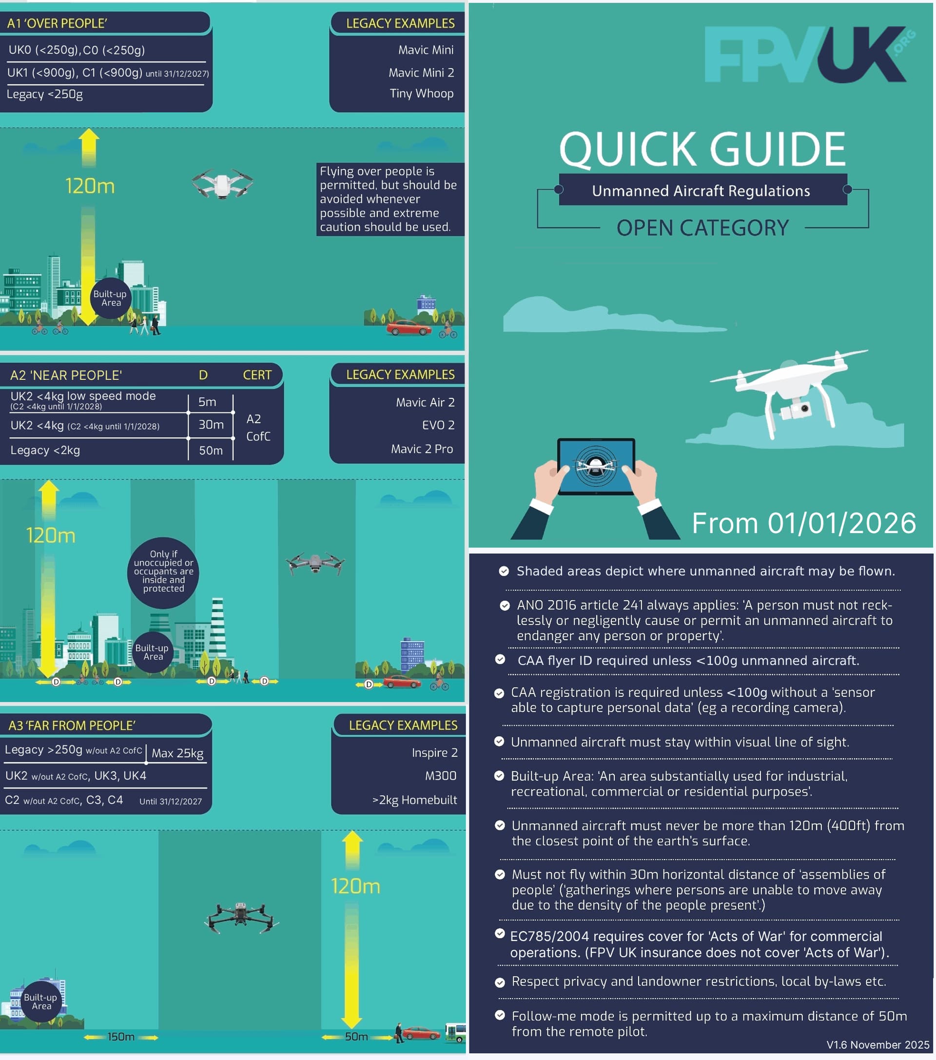

So here is my question, as members of FPV UK are we able to use article 16 in Spain and the rest of Europe. Why I hear you ask, well ile tell you :grin:. My drone is 249g & that is fine but in order to fly in low light I attach the appropriate strobe lights, Red- Port / Green- Starboard & white- Rear. This increases visibility and orientation assessment BUT it puts the drone overweight, this is where Article 16 becomes useful.
Any help would be appreciated.

Since Brexit, anything issued by the UK authorities (operator ID, flyer ID, article 16 operational authorisation) is valid only in the UK.
However, if your drone is C0 (or C1) marked, it can be flown in exactly the same way as a sub-250g drone now in the UK, despite it being over 250g (up to 900g in the case of C1).
The same thing will be true in the UK too come 01/01/2026.
