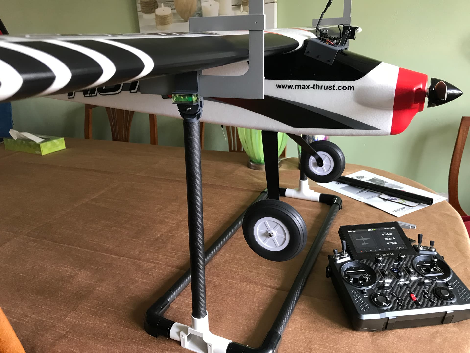

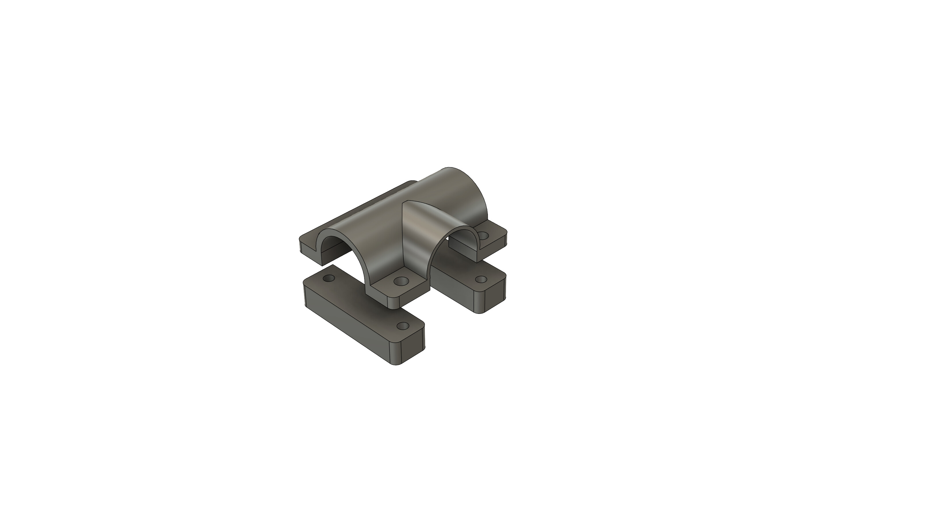

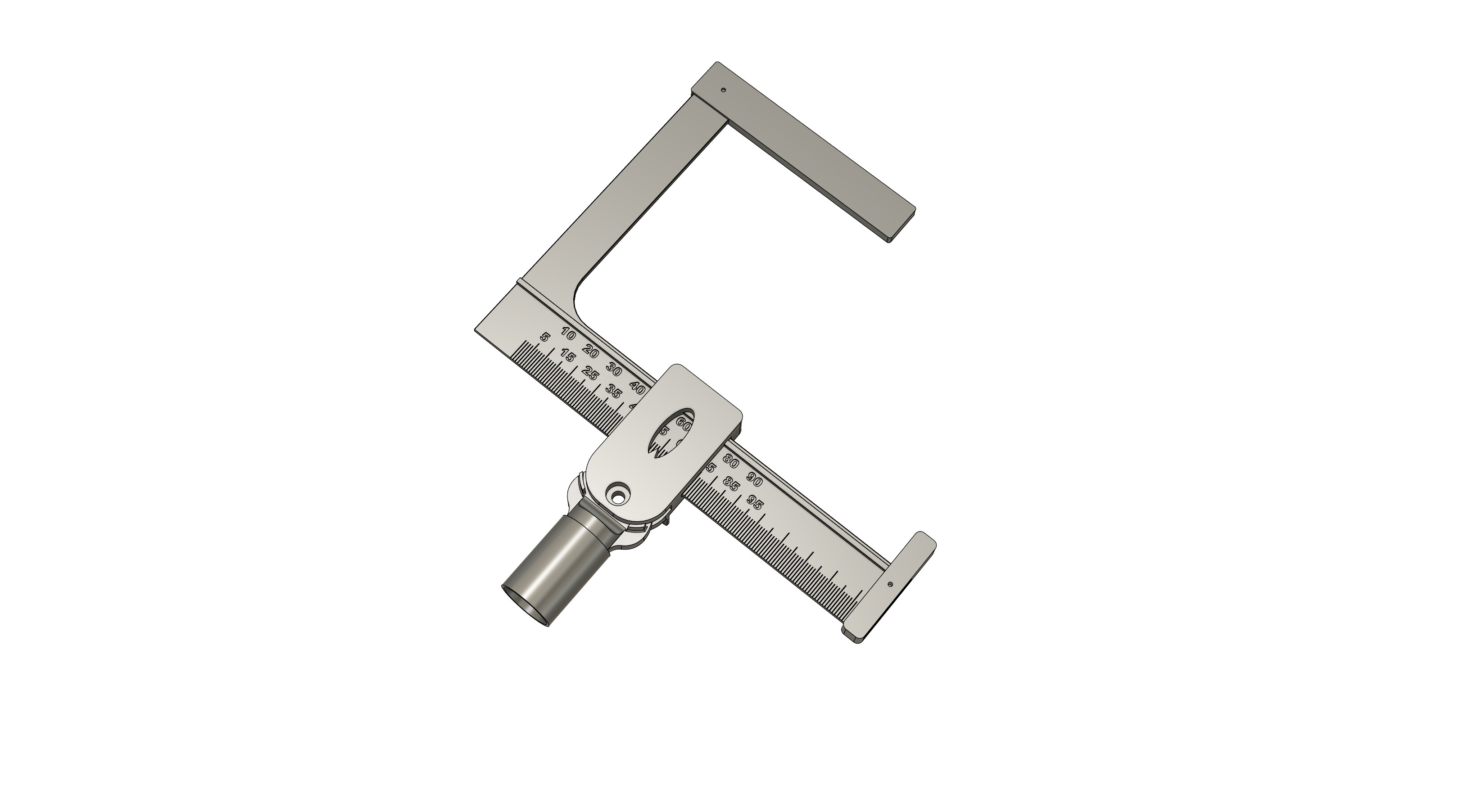

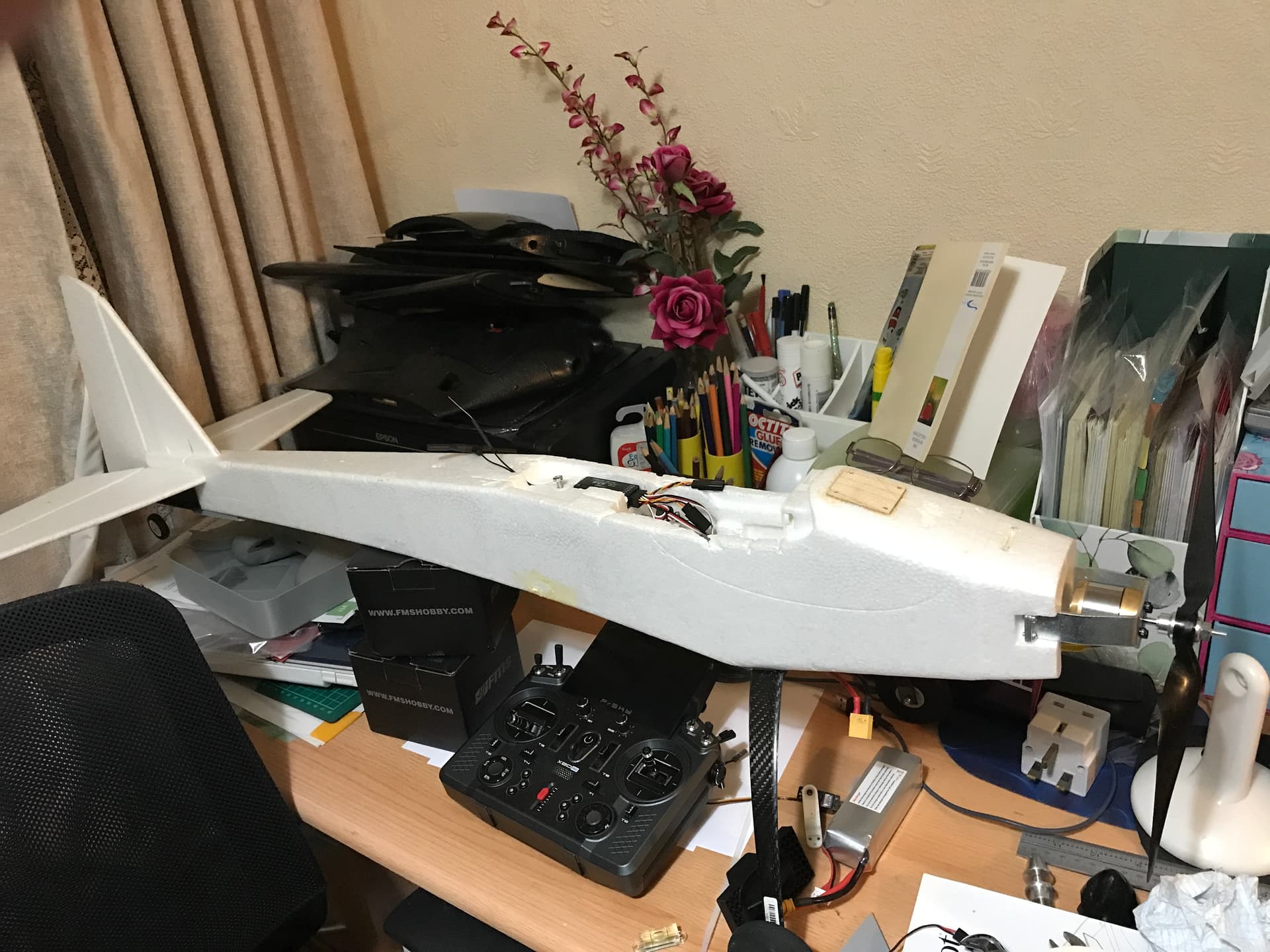

I couldn’t get it to balance, so ended up designing a C.G Jig…

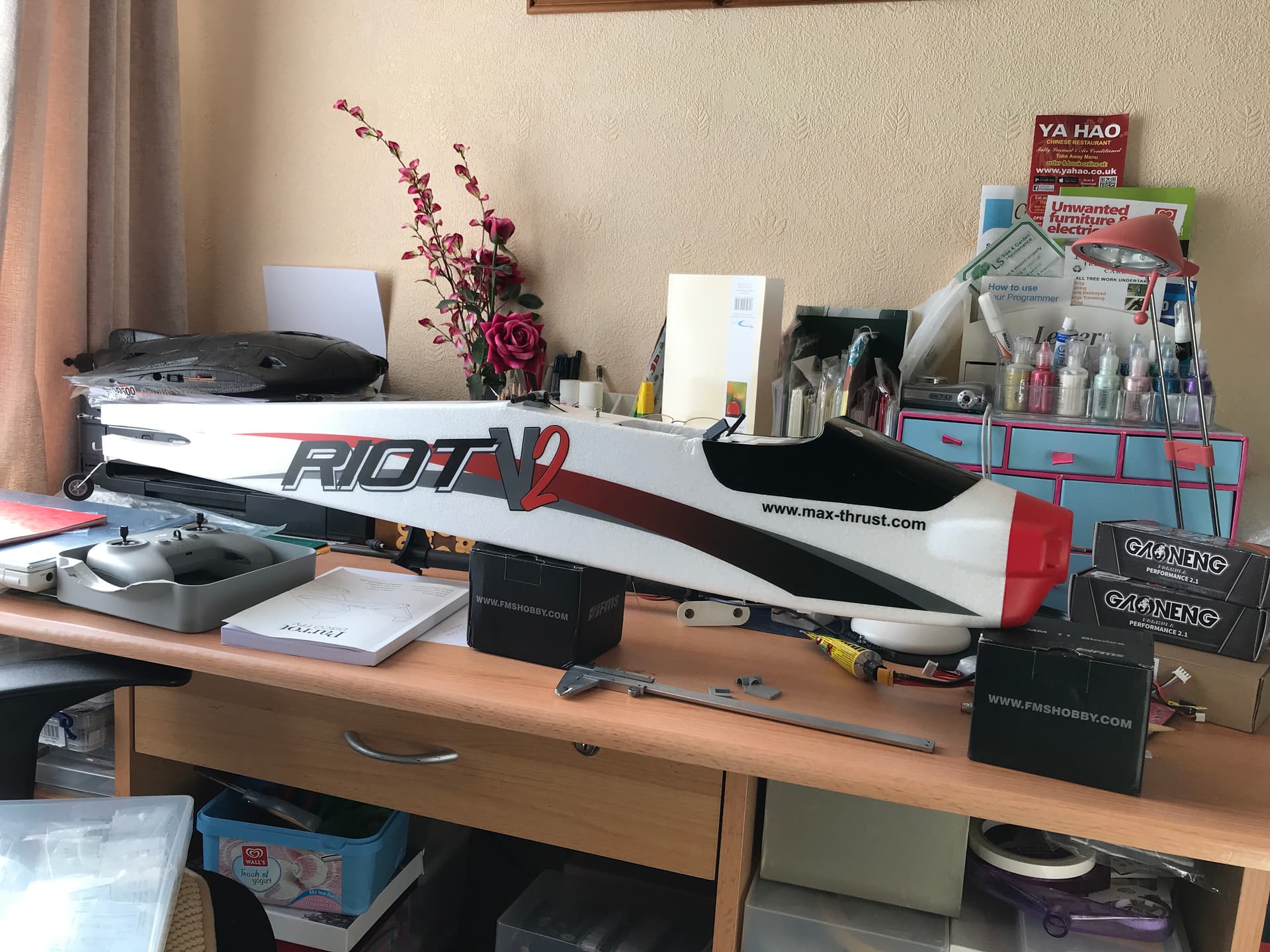

So the other day this arrived and it’s now going to convert to FPV… :thinking:
Although it’s meant for 3 cell. I’m chucking in a 4 cell, I need to work out where to instal a Dji Lite Air Unit. I’ve got a Frsky S6R Dual Band RX which is stabilised and although the RX has both 2.4G and 895MhZ, I’ll be flying short range at the club.

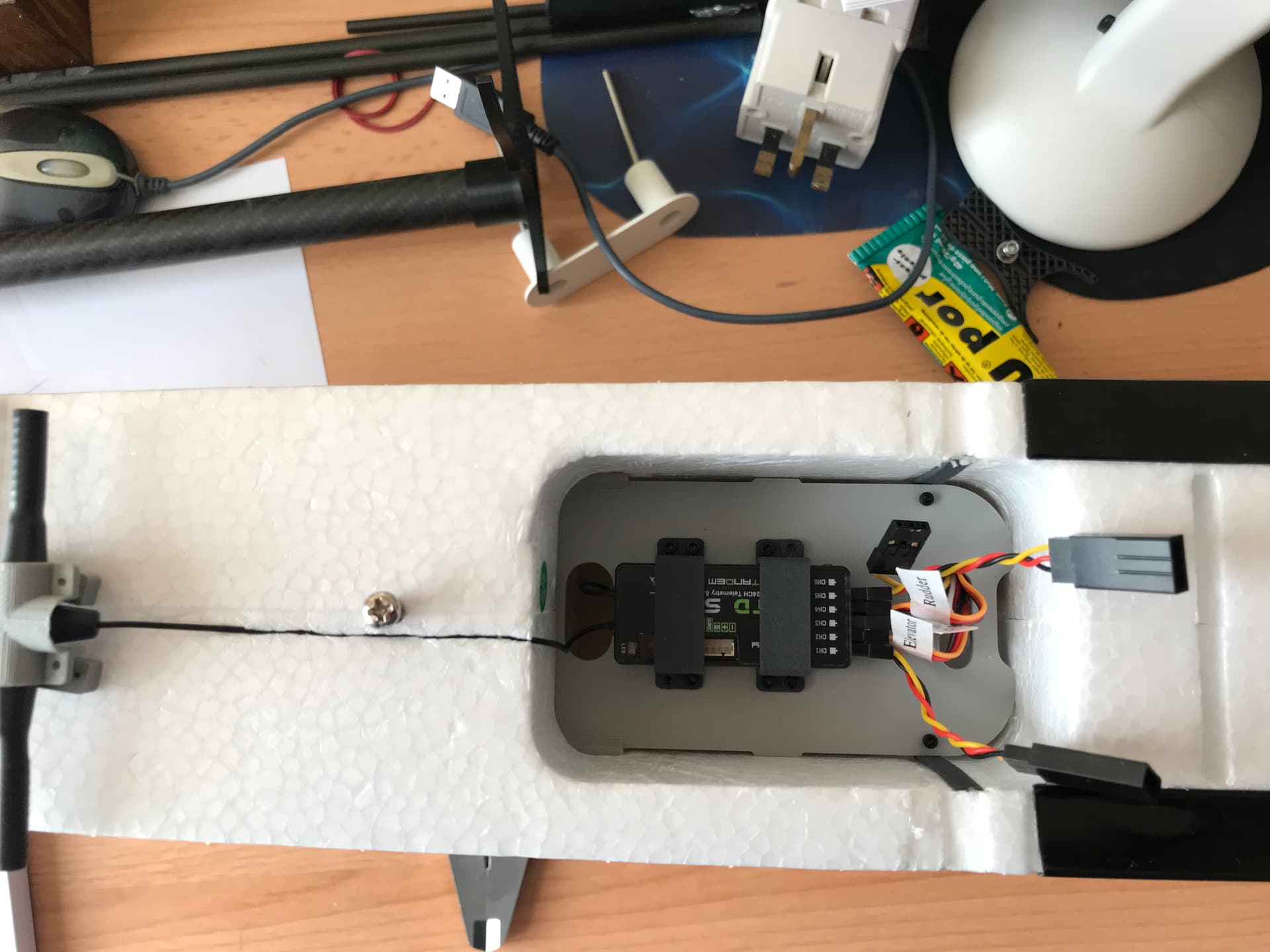

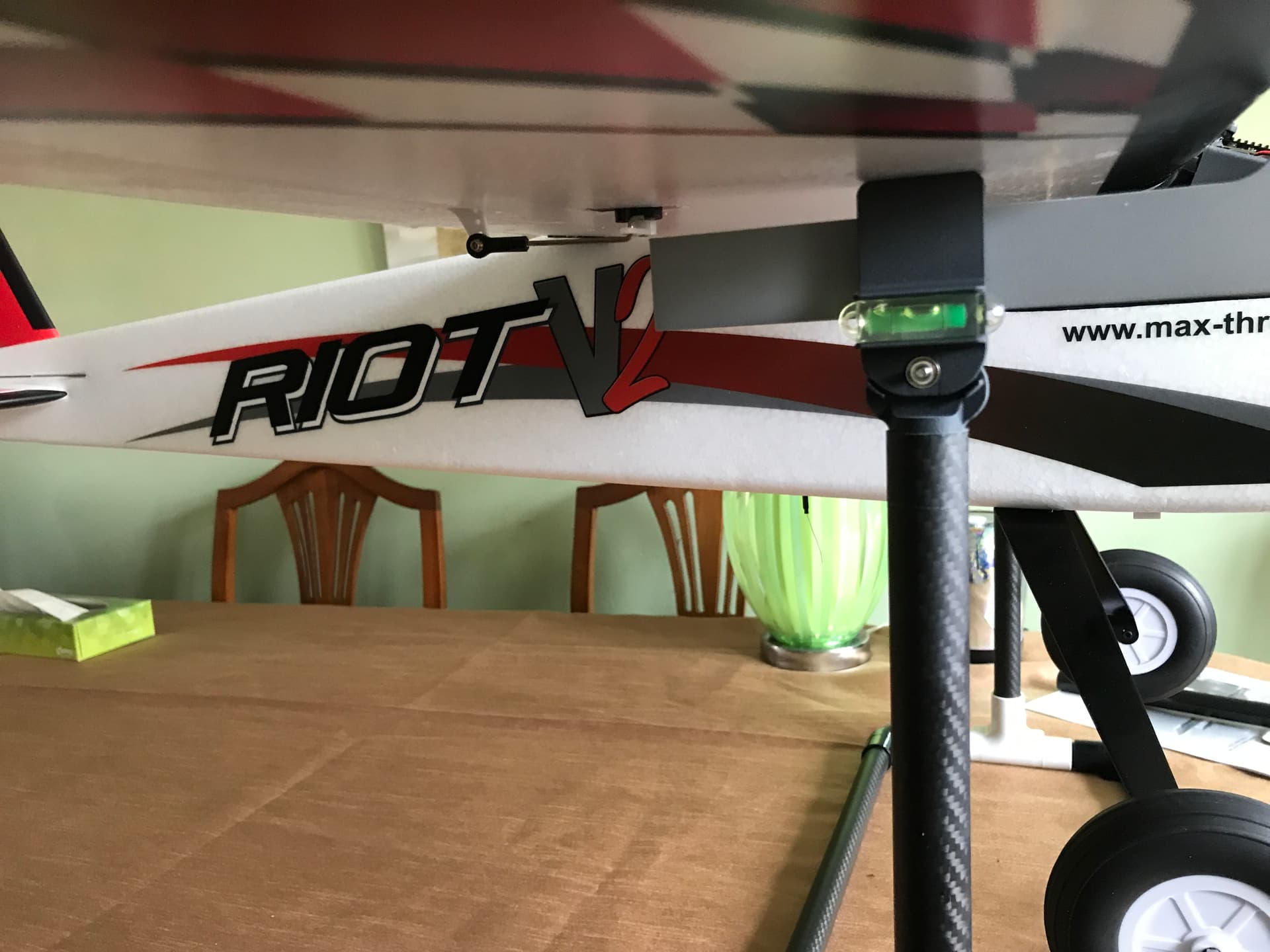

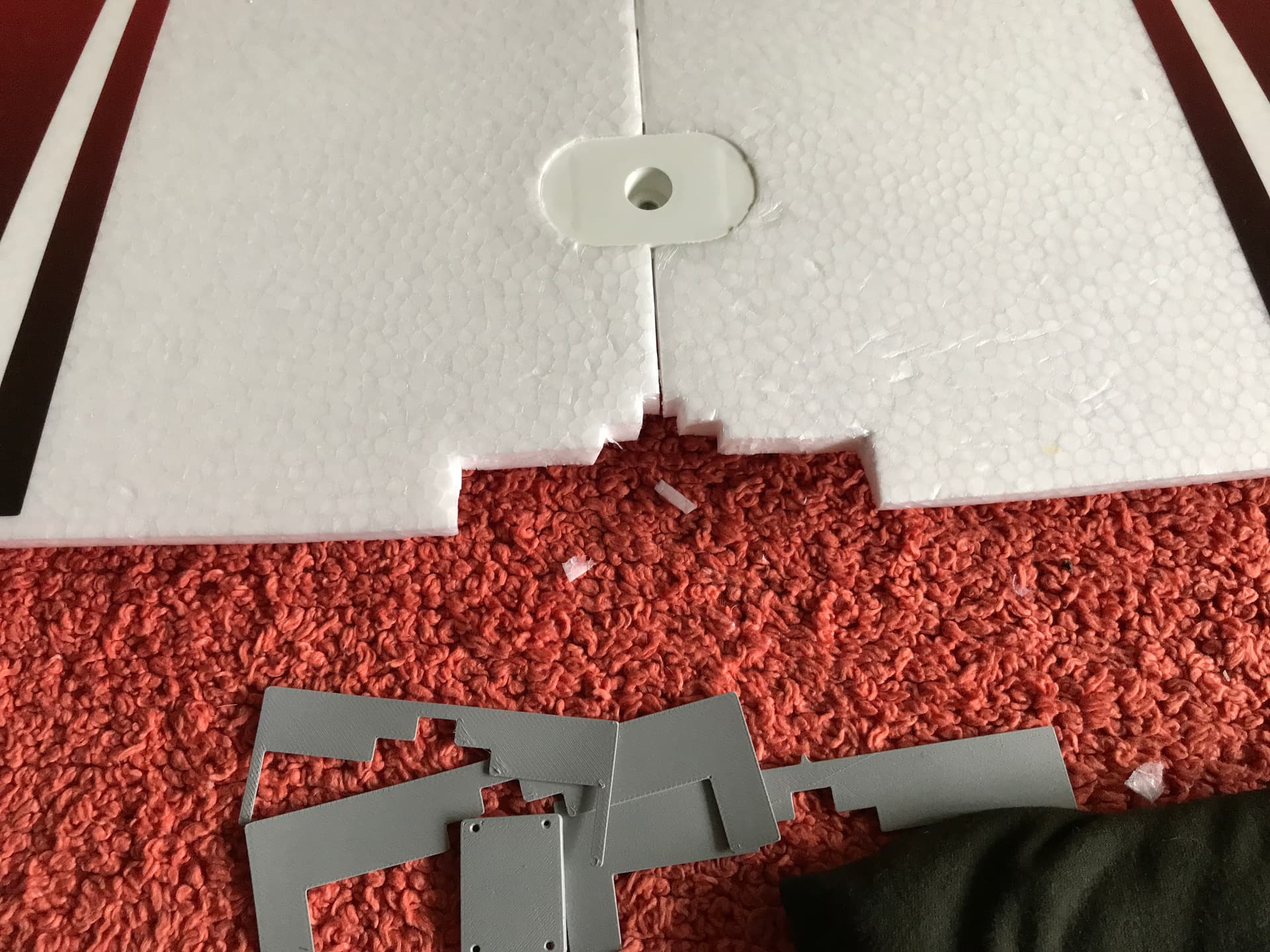

I’ve spent a few days working-out how I’d fit the RX and eventually came up with the only option which is to print mount a new floor in such a way that the RX will remain spirit level with the XY axis. The level was archived with a couple of small spirit levels.
The 895MHz mount

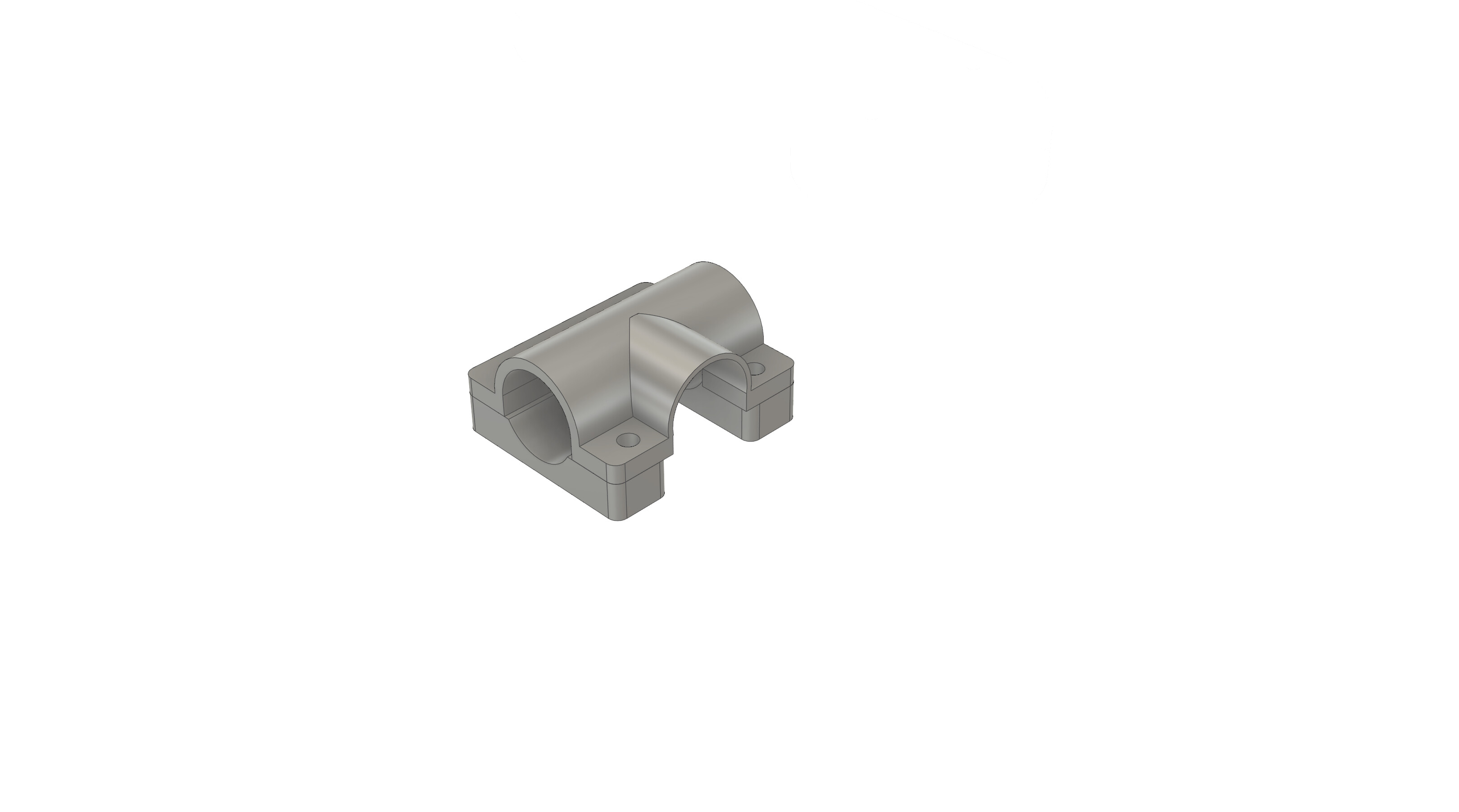

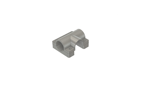

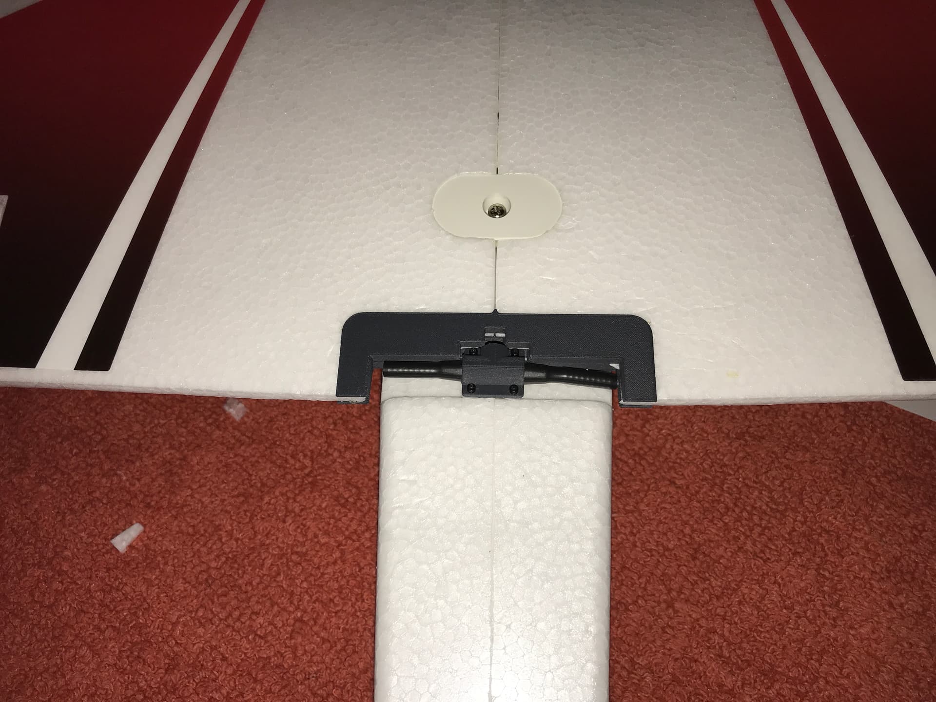

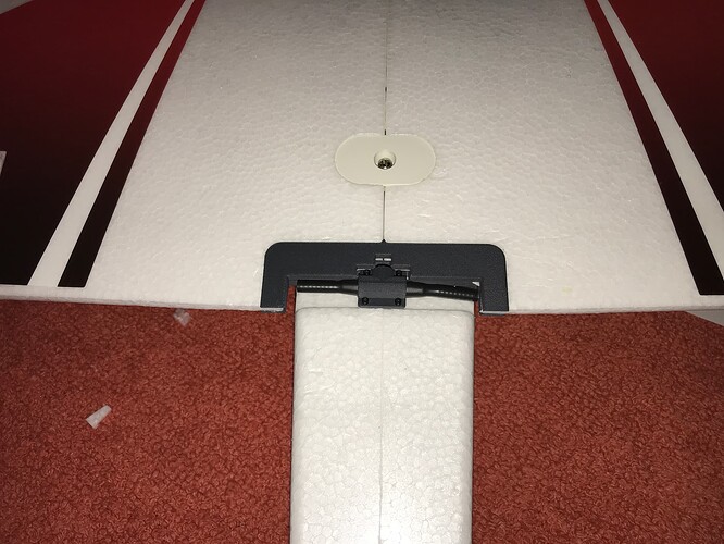

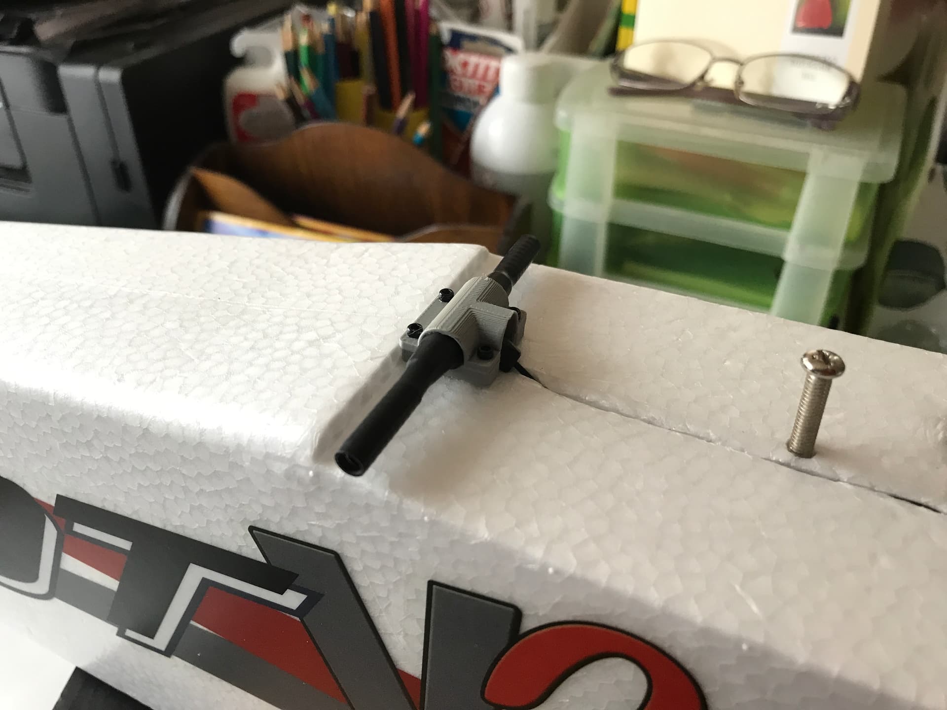

I’ve finalised the antenna mount design, and will be cutting the wings’ trailing edge around it.

So that’s the antenna mounted, But having glued up, it occurred to me that PLA-Carbon may shield the antenna?

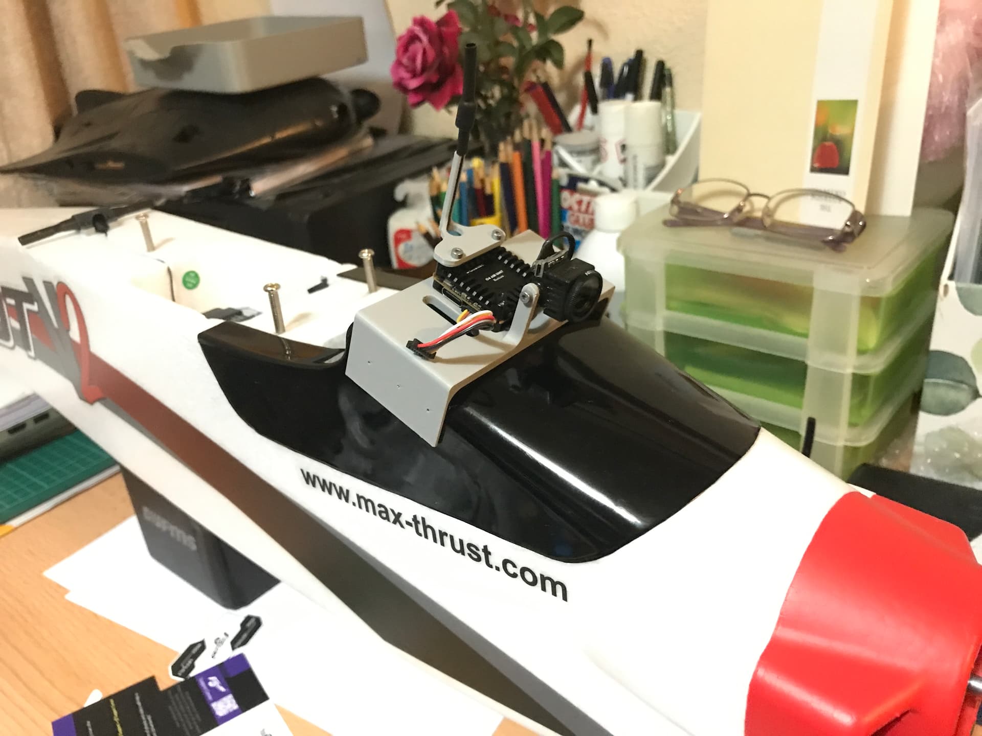

I just need to cut the canopy for power to the 04 lite…
Quick update…
Maiden yesterday VLOS, a little ironing out needed and hopefully FPV maiden next week

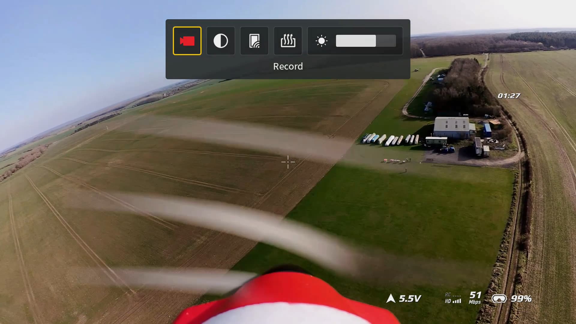

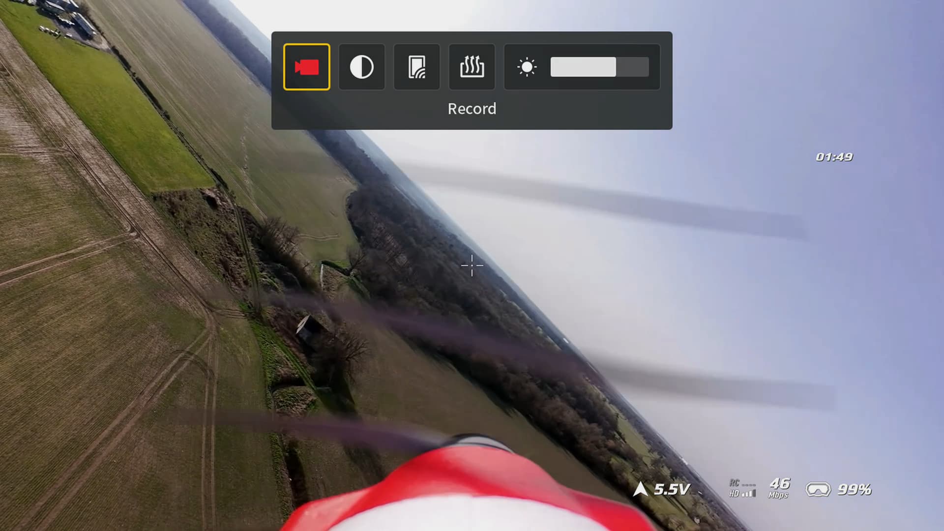

I just need to get rid of the prop strobing, suggestions anyone?
Been experimenting …looking for the sweet spot for average shutter speed that eliminates Prop strobing..

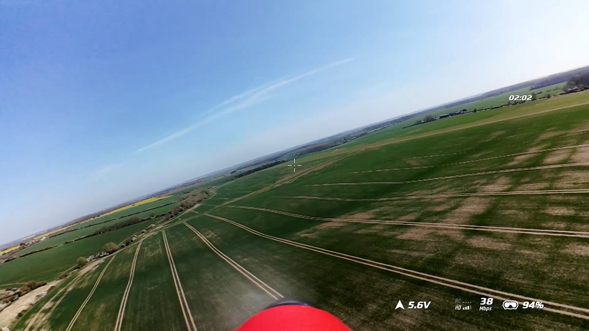

I forgot to record the FPV maiden… :roll_eyes:
Flight test
