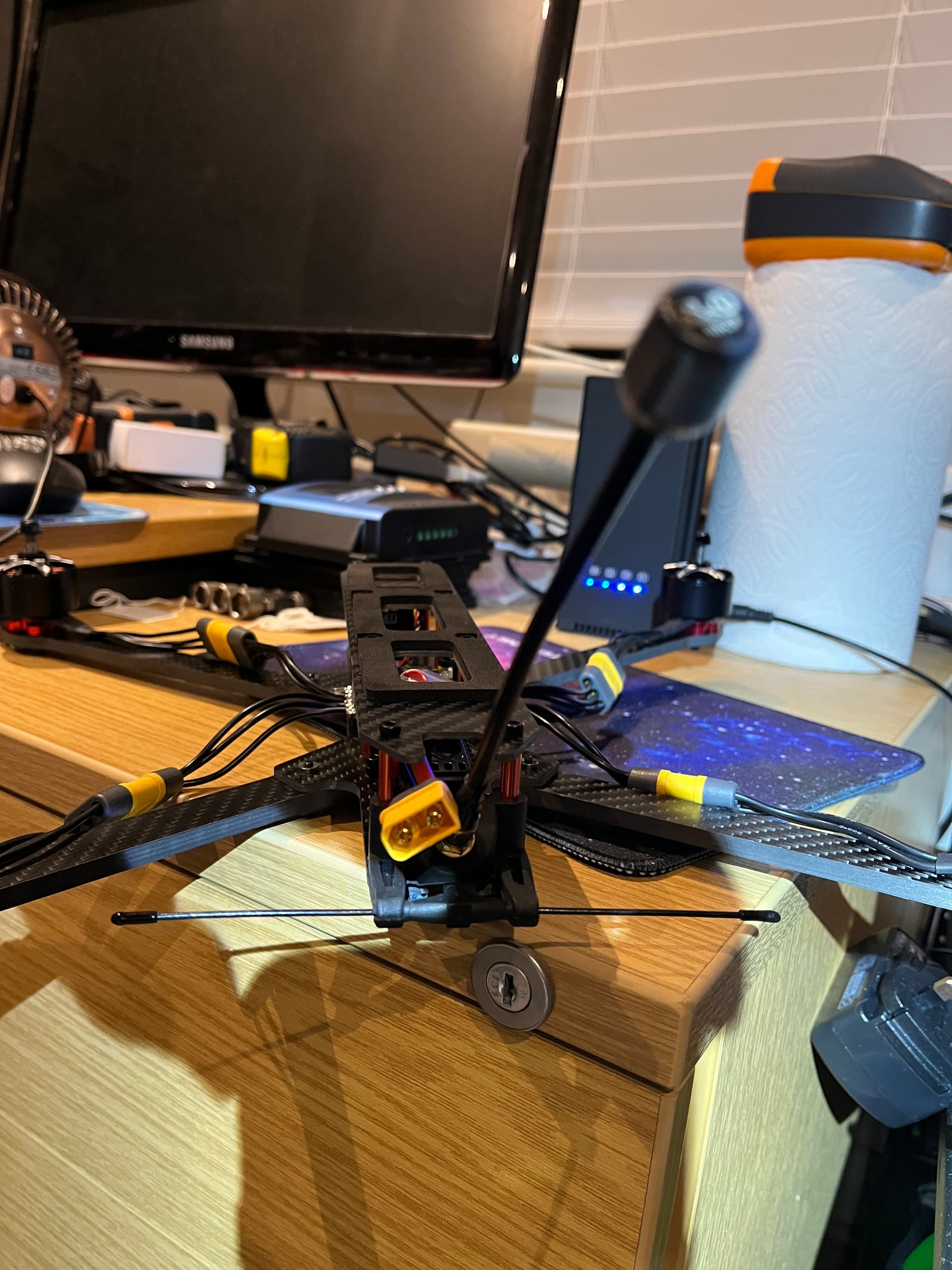

This is the 11" frame I call ‘The Beast’ it’s attached to a 3-30v/10amp bench power supply. While the PSU doesn’t provide as much power as the battery will, it does allow for setup and testing! Props not fitted yet!
I’m using a RM TX15 MAX 2.4G/915Mhz for TX
Show us yours…

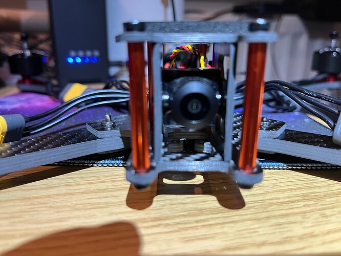

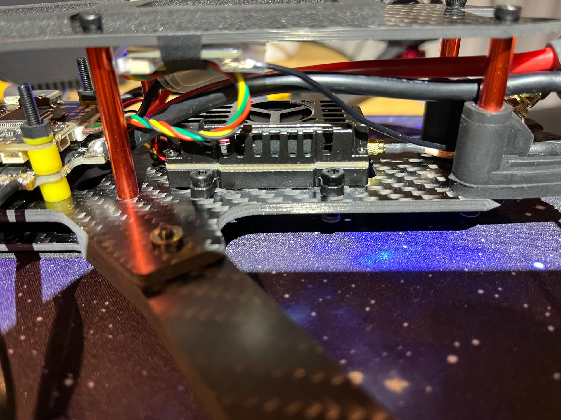

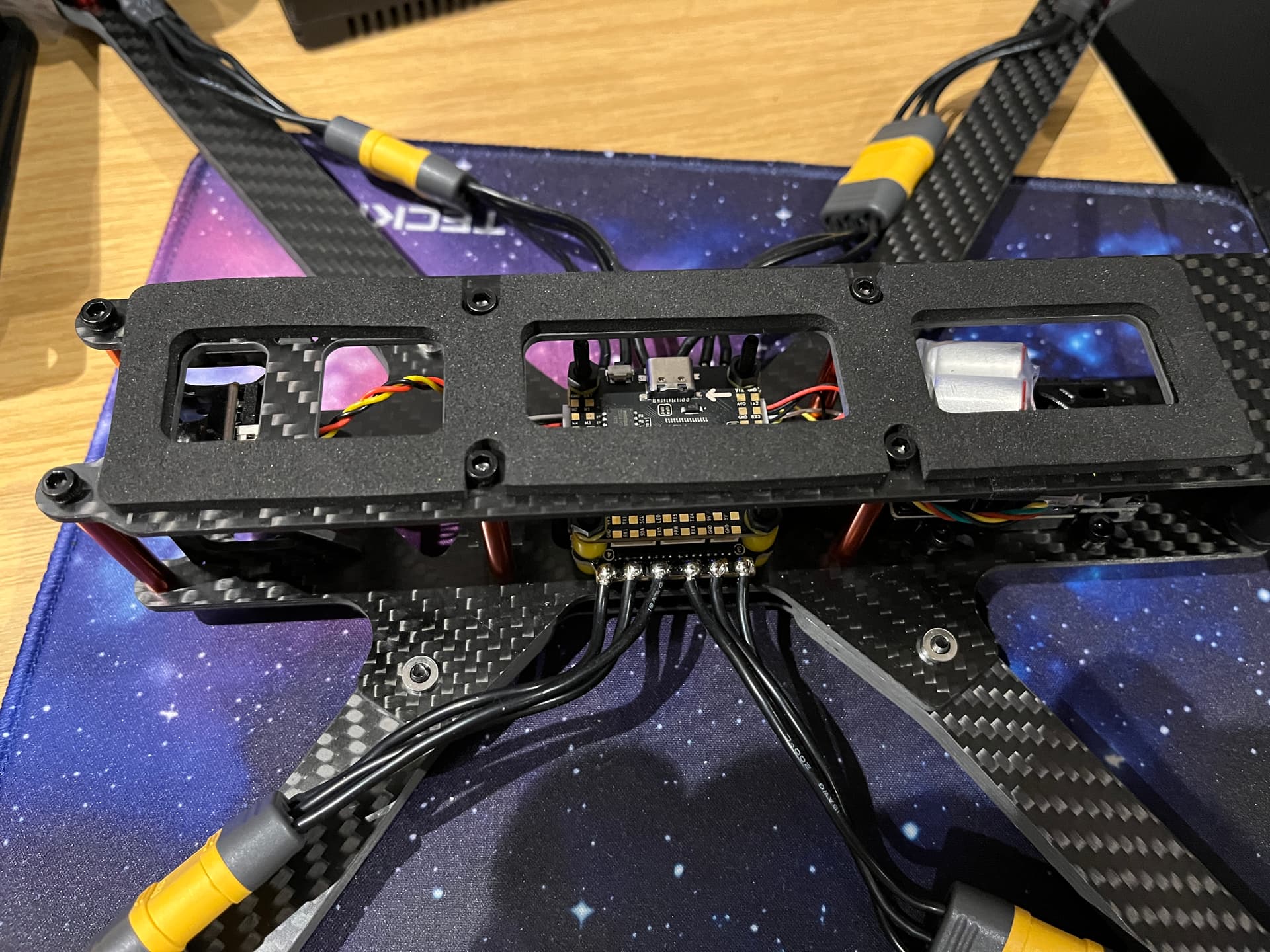

I’ll try to get some pictures to show the electronics, even if I have to take the lid off…
Pictures as mentioned…
Battery seat on top
Camera, basic version, may be upgraded
Two antenna - 915Mhz & 5.8Ghz
VTX & nano RC TX/RX units
I think I’ve identified them correctly, I’m sure someone will correct me if not…
All very compact!
Very nice Steve!

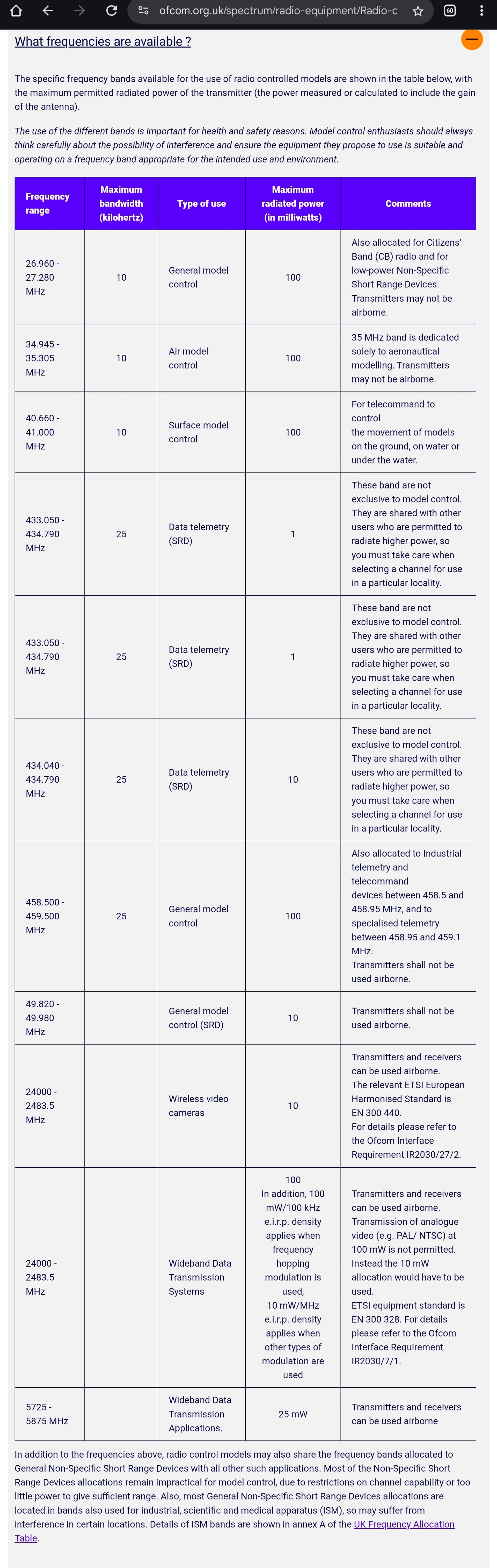

What’s the 915 MHz antenna for?
Thanks @SimonDale
915 Antenna = RC TX, via the RM TX15 MAX

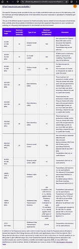

Oh right. How interesting.

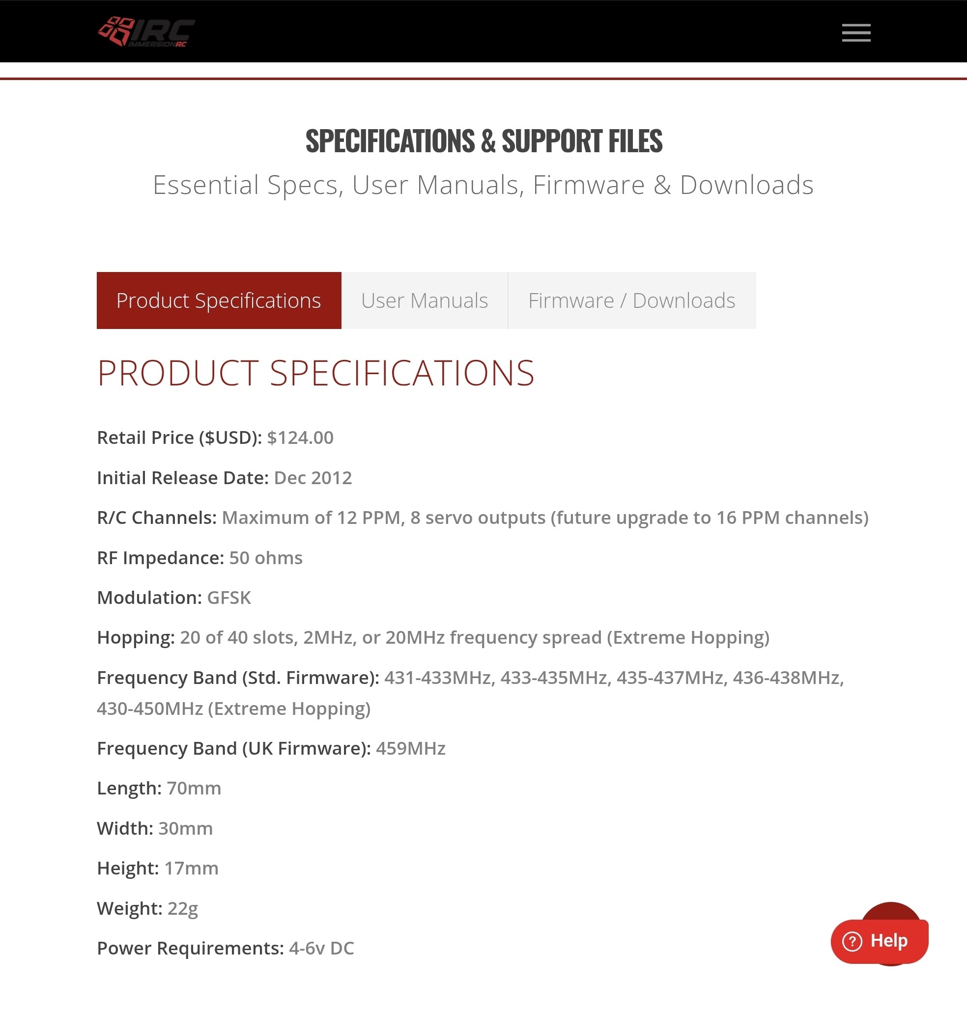

I didn’t realise that was being used in the UK. (It is not one of the allowed frequencies.)
It takes me back. About 13 years ago, when I ran an FPV shop, I got ImmersionRC to do a special UK firmware for their EzUHF so that it operates on 459 MHz (as against 433 MHz elsewhere), so that it complies with the UK rules.
Thanks @SimonDale I’m going to have to look at this in the morning. Maybe a replacement RC TX/RX module will be required…
It looks like your radio/ELRS will happily work on 2.4 GHz instead?
If so, it’s just an antenna swap. :slight_smile:
Or flash the 868 version of elrs firmware. It’s pretty straightforward to do and keeps the long range link.
